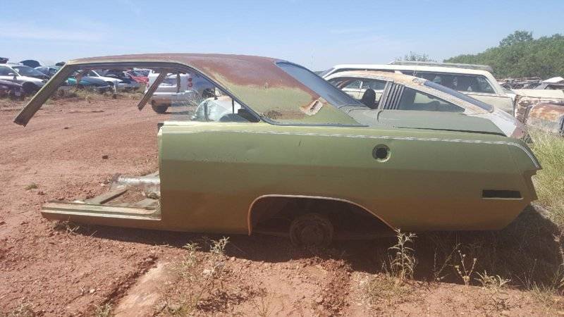

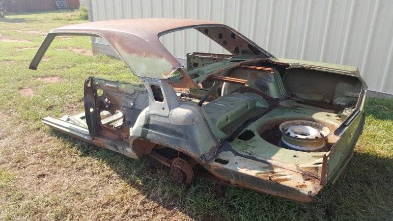

Picked this little beauty up splitting cost in halvsies with a fellow fabo member who needed all the rust free outer skins, dutchman, glass, trunk extensions and outer wheel houses.
I need the rear seat/transition pan, rust free uncut trunk floor needing the typical patch work in the spare well, inner wheel houses, rear seat bracing, and right rear foot pan to repair the main floor in the cuda. For the most part Its all light surface rust. Looks worse than it actually is.
We are slowly cutting the spot welds and dissecting this thing to save all the metal we need. Will eventually have a nice solid roof skin for a 2 door hard top dart or scamp, and rust free framerails for sale
With the Scamp sheetmetal, AMD parts, and Goodmark quarters i am getting closer metalwise to unF@@King this car.

Getting closer to harvesting the sheetmetal out of the scamp. Its been slow going between work, and home life but i'm getting there. Got a nice rust free spare tire well to graft in from another list member.
