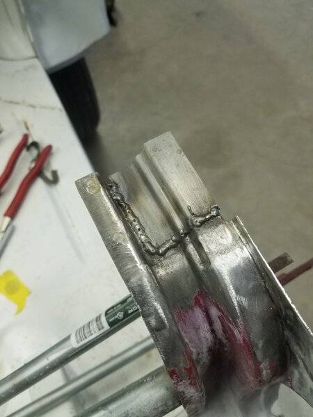

Been busy with a bunch o other things, but took a couple hours today to get a bit farther. The water channel with the original vin is now welded back to the car after repairs. Trunklid is fitted, and rear quarter top on LH side will get welded in later tonight or sometime tomorrow. All the temp bracing has been removed except the 2 pieces supporting the LH taillight bucket. Everything fits really good. I am very pleased with this.
LH side was only clamped in place yesterday. It's all finally welded in now. The repaired LH trunk drip rail channel with correct vin # stamping that the car was built with is back in place where it belongs. All the temp bracing is now cut back out. Once everything is seam sealed, primered etc. you wont ever be able to tell this thing was ever apart. It was a lot of slow going, planning, and head scratching to figure out how I was going to do this. I had only one shot to get it right. Honestly, I think I nailed it. I also think i must be turning the corner to making serious progress. No fun pix of cut off scrap metal to show today, I only swept up grinding filings.
