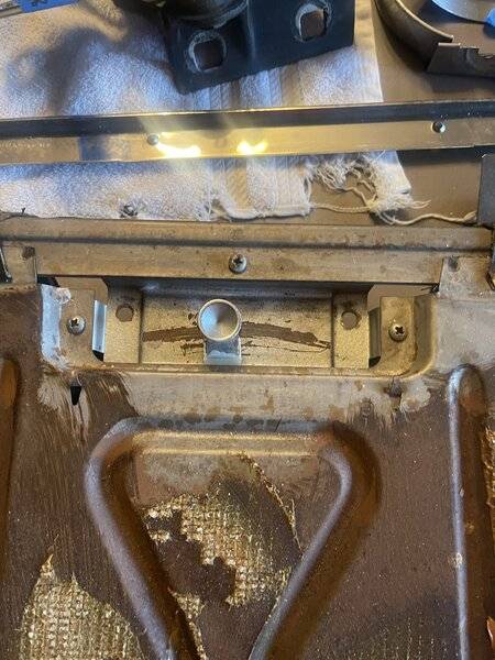

We pulled the side mouldings, escutcheon, and finish panel off. Then peeled back the carpet - it looks like the carpet was glued. Here are pictures of where we are now shown below. Seems like the next step would be to bend back the perimeter tabs and roll the seat cover back. I’m worried that the tabs might break though. Also, those look like spot welds at either side at the top of the escutcheon, so I don’t see how the back plate comes off. So if we peel back the seat cover, do you access the inside mechanisms from the front of the seat instead of the back?

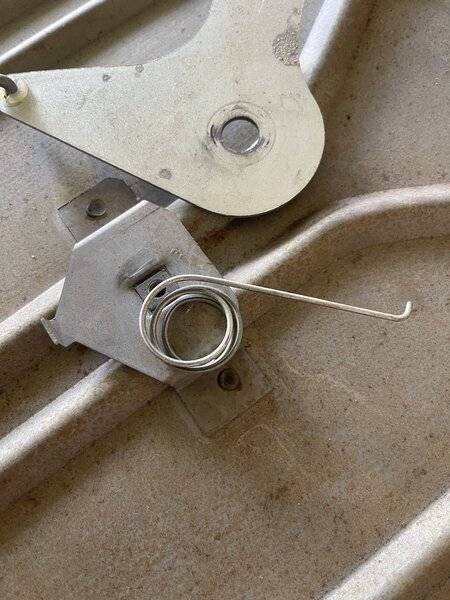

I pushed back each of the tabs in the seat back cover and carefully peeled it off. Looks like a couple of damaged parts inside. The rod link must be bent and the spring appears broken. See pictures below. The release rod looks okay along with the bearing/lever assembly.
Anyone know where I can get a new internal rod link and spring?

I’m happy to report that the 67 Barracuda back seat is completely installed and operating properly.
Thanks Dana67Dart (seat cams), Rat Rod AL (spring and link rod), barracuda kid (hinge covers, shims). Other parts came from Amazon and a local welder fixed the broken spot welds inside the seat (free for a ride in the car).
Biggest issue during reassembly was getting the spring frame in. My spring frame sits inside the seat frame on the top and sides, then sits on top of the seat frame on the bottom. Once we figured this out it reassembled perfectly. We also also added a stop to the lever inside the seat to keep it from over advancing and getting stuck.
