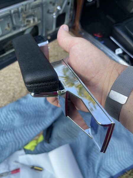

These are the front arm rests I ordered from Classic that arrive this Saturday. Hope they fit.

Here is a picture with the door panel off. Also, the arm rest from Classic fit perfectly!
