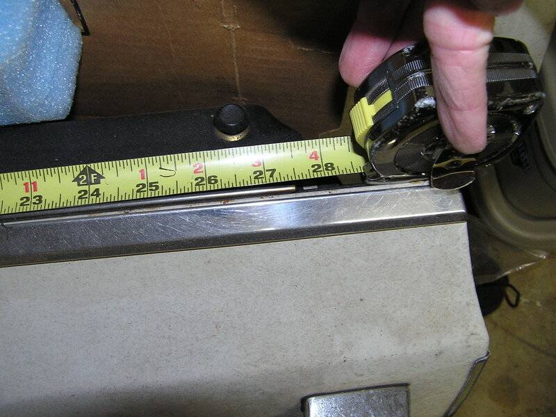

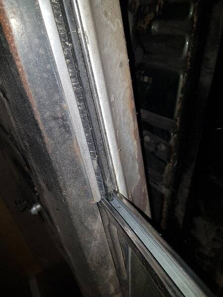

Heres what I have, 1st is a 67 door, I believe it's from fastback. Also unsure if original or not.
Outer felt is slightly longer at 27 3/4". BUT outer starts approx 1/4" further forward to front of car.
Inner felt starts 1/4" BACK from start of outer. Total length 27 1/2". Also at end of inner felt, the chrome is bent at 90* approx 1/4".
2nd pic with small screwdriver shows where chrome for outer felt starts slightly closer to front edge of door by about 1/4". Both 67 doors measured identical.

@4spdragtop, thanks for the photos of the 67 door. From looking at the samples sent by the customer to what we have been using, we are finding that the difference is the outer door felts for a 67 door, the inners are the same from 67 to 69. The 67 outers measure 27 and 13/16 inches where the 68 and 69 measure 28 and 1/4 inches for a difference of 7/16 inches.
Not only is the overall length different, the attaching clip location is different for the 67 Fastback year model.

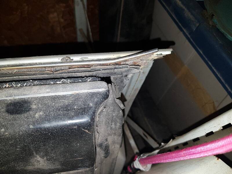

@RPM440+6 Sorry, I have no spd on 67 doors. I took pics of 69 vert doors but didnt get measurements, sorry forgot the tape measure lol. What I noticed is the 69 inner felt is quite different in that the "chrome" is a different profile and much wider. I'll get pics with measurements.
Back to the 67 inners and outers with my uneducated eyes....both appear to have same profile and length. Altho the inner is set slightly further back by about 1/4" the inner has the 90* bend for approx 1/4". So equal length and similar profile. Could they swap inside to out? Hope that makes sense.
Heres pics of 69, I'll get some with measurements.
