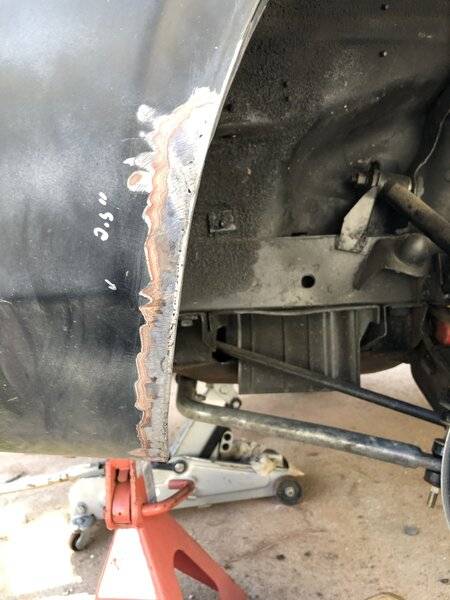

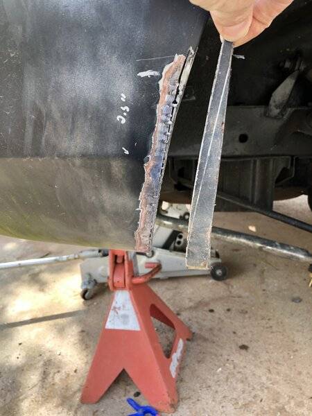

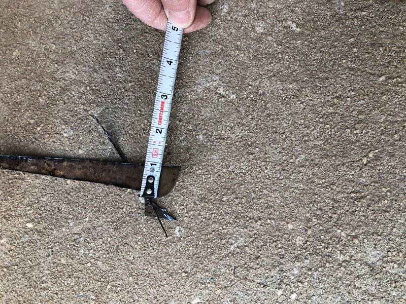

I been down this road with my 67 barracuda FB with the 215’s and even 205’s. I have the later 73+ disk brakes so it also increases the track with making the issues worse. My car is just a toy hot rod nothing special. So I opted for removing an inch of the fender opening. To create enough room.
