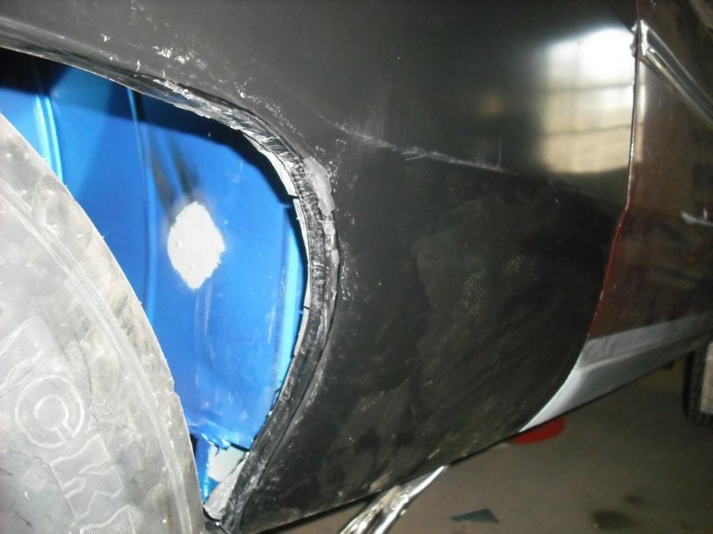

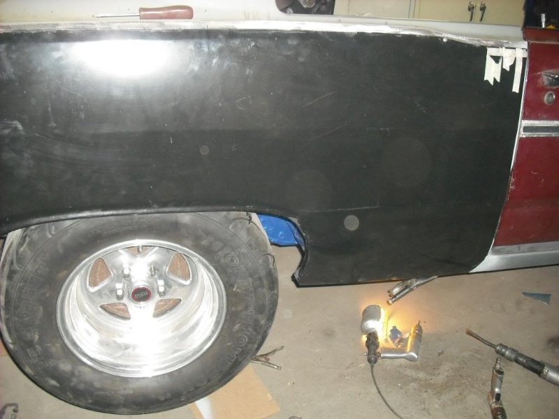

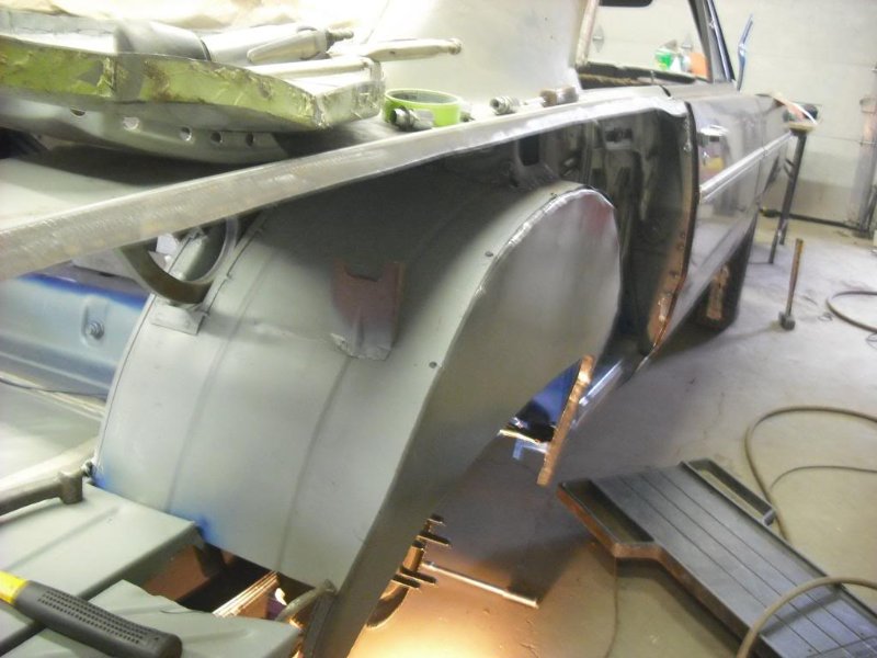

I shortened my rocker 1" and trimmed 1" off my new quarter panel and tin knocked the wheel opening lip. I did 3" inboard with SS springs but put tubs in instead. Yes I know some will dislike shortening the rocker but it's my ride.
