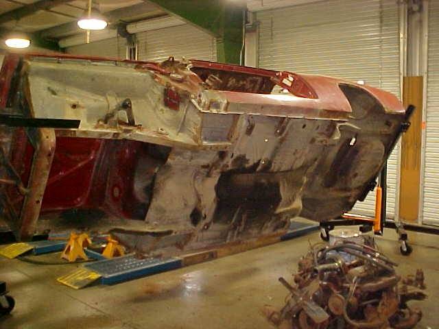

No sagging issue and did not support it. The car was completely stripped. We test fitted the doors when we were doing body work to make sure the style line at the front of the quarters were lined up with the doors and the doors fit perfectly in the hole. (lucky I guess)

Just starting this project. Got a long way to go but I though I might as well show from the beginning. 273 commando 4 speed car. Probably will go with 360 though. I am having trouble getting the quarter glass out.
Bob
attachment.php
I dont see torque boxes in front and rear frame in picture above? Does torque boxes available only with big block car in 2nd gen Barracuda?
