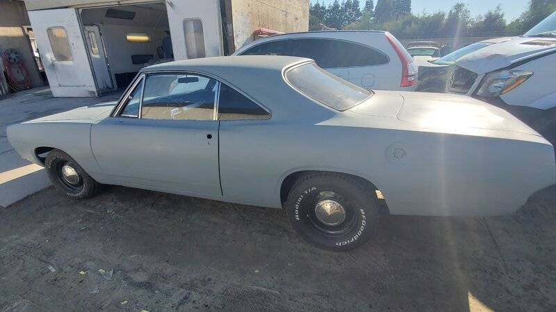

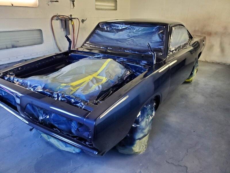

It's in the shop getting ready for a re spray finally, going with same dark blue base then clear with black tail stripe.
