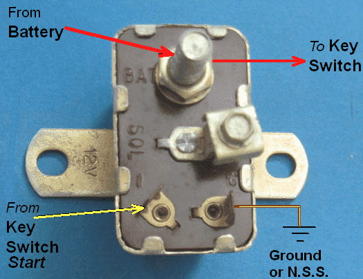

Cranking is the Start wire. S2 (yellow) on the diagram. Goes from the key switch S terminal to the Starter relay terminal.

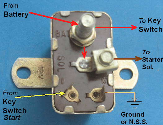

How the Starter Relay Works
Key in Start.
Power is available through the key switch (S) to the I terminal of the relay.
With the power now available at the I terminal, if the G terminal is grounded ( through the neutral safety switch if an automatic transmission), the relay is activated.
Activating the relay causes the battery stud to be internally connected to the solenoid terminal.
Power now flows to the starter solenoid.

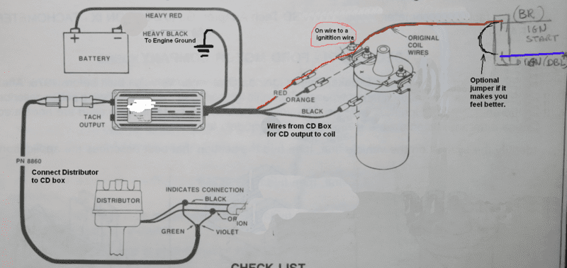

MSD 6 series instructions from Autotronics marked up.
Starter relay wires should not have been involved.
Original coil wires removed from the coil
Former coil feed wire (brown) is used to switch the MSD unit on.
If using the original points distributor, MSD white wire is connected to distributor wire.
If using magnetirc pickup distributor then use the wire pair as shown in drawing above.
