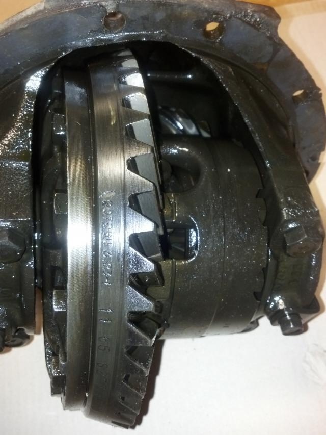

Scored a 4 speed today, a body, and a 742 3:23 SG complete rear, couple of tq carbs and a 360 intake. less than 4 bills so I figure its a good starting point. still need so much stuff. radiator, pedals, flywheel, got a yoke, got two old hurst shifters too, one still bolted to the tranny. pics later, its dark and I cant unload this late. Left a 67 318 orange block, but was a -7, don't think it was a real orange. still may pick it up later, had almost no ridge and crank and pistons.
dammmm freakin 4 spd turned out to have a 5.125 front bearing retainer, but the shifter arms where both pointing in same direction and gunked up with road dirt. I shoulda looked at it better, looks like an OD unit from 76. wonder what that would run like with a 360 with 323 gears. Maybe I'll trade it out for a regular A833. The SG turned out okay. gears in great shape and marked with 3.23..lot of other numbers I haven't decoded. looks like a date, 12 28 65 B. and a 2070611 and 22885X,

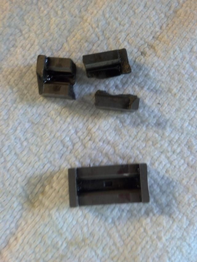

working on the OD 4 speed I picked up. looked really good, after finally getting the gears out I found a piece of a syncro key in the bottom, sure enough one missing, I found all the pieces and after inspection found the ring gear where it came out of had a nice chunk out as well. Ordered the parts and the full rebuild kit. Will have a nice rebuilt OD for less than 300.

heres picture of the synchro key.
