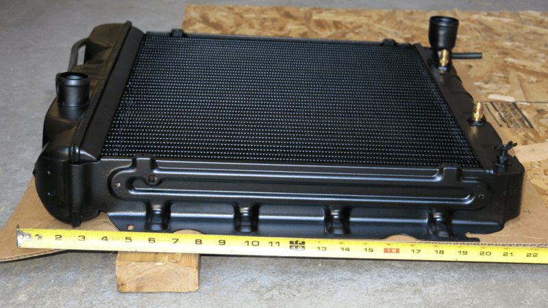

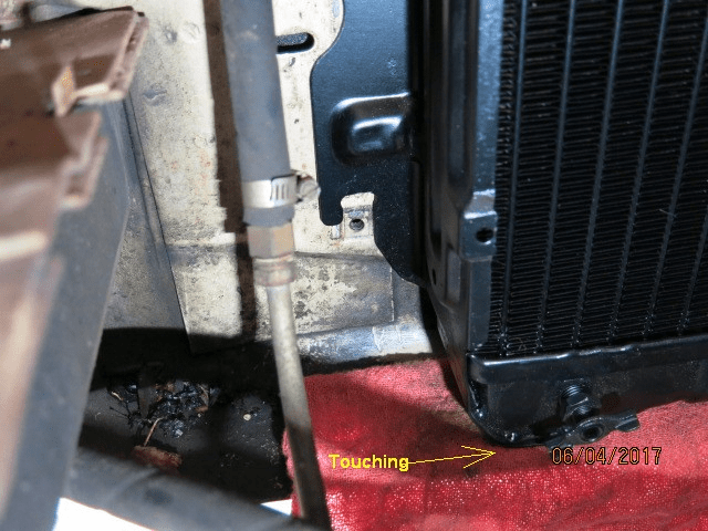

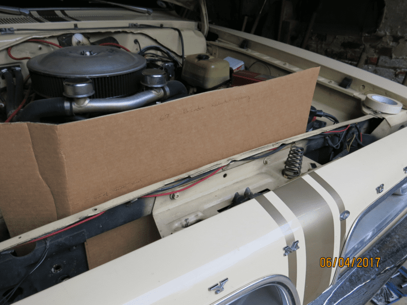

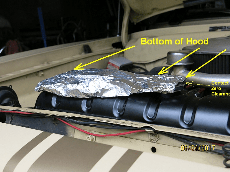

This 67 radiator came from Tony Fields and I am concern it might be to tall, I don't have my hood on to check it, anyone have any experience with this ?
Thank you all so much
First 3 pictures is the 67 radiator
All others are when the /6 radiator was in

Sure looks it. Time for tape measure, paper and pencil.
When I've had to get replacement radiators, I've used cardboard to trace over the mounting flanges etc of the radiators and the openings. It helps when figuring when figuring out what's different.

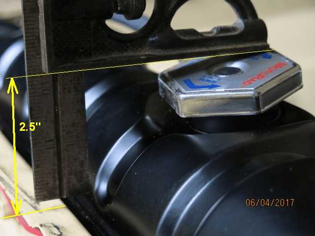

And this - which is a 68 with 70 bottom tank.
IIRC the 70 tank is taller than the 68-9 tank so the core has to be shorter.

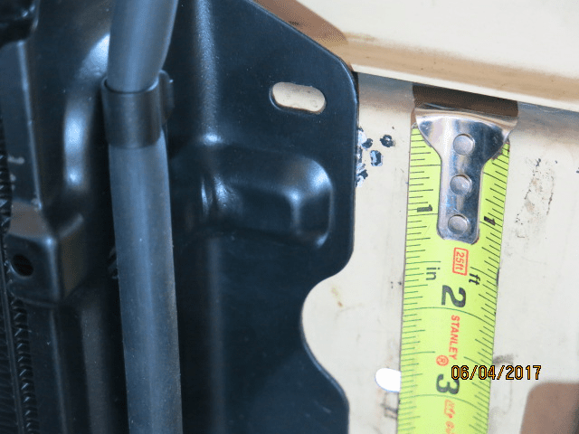

Measure this
and then these

thank you for your insight on this , I will go out today and bolt it in and see how high it wants to set, this is a custom build radiator because the lower hose is on the passenger side like the later models, I hope it will work for me , if not I need to get started saving for an aluminum radiator.

Good chance if its a combo radiator like he made for my 67 we found the 70 bottom tank or cores are a little taller than 67-9. He shortened the core and all was good.

I have a 67-up radiator in my 66 valiant. I had to modify the mounting holes and mounted it almost resting on the bottom tank.
to get my hood to clear.

Thank you, this helps ease my mind, I think once I do what @krazykuda did I should have plenty of room, thank you all very much.
