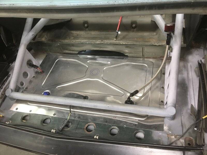

Then I received my new fuel tank with integrated sender unit, inner baffles and AN fittings. I cutout the rear trunk floorpan to fit it in-between the frame rails with its own removable structure so I can easily drop the tank in the future if need be.

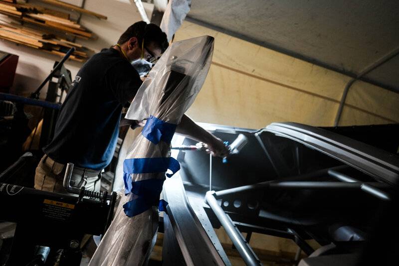

More cage work with the roff off to finish TIG welding all the top welds properly ...
I also fabbed up a new jack point in the rear of the car, welded netween the frame rails. It also adds rigidity and protects the fuel tank as I won't be fitting bumpers on the car.

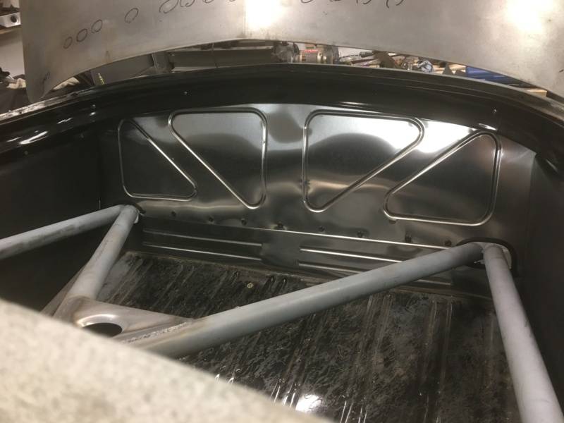

I then clsoed the hole behind the fuel tank with a piece of sheet metal from the old rear fenders that I had cutout 3 years ago now. Some dimple dies, or speed holes if you wanna call them like this, to make it stiffer. Some of the welds were a bit shady, I'm not extra happy with it but in the end, the trunk area will be painted with a kind of wrinkle finish so you won't notice it so much. But welding onto 50 year old steel isn't always a pleasure...

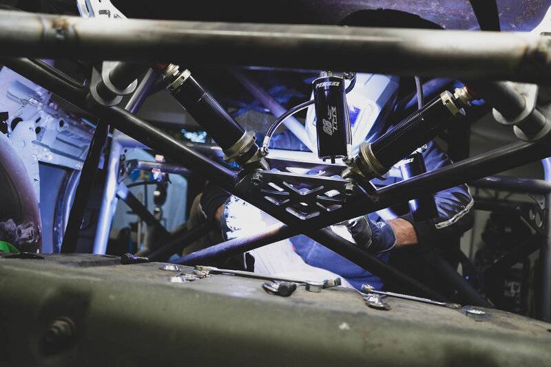

I still have to build a 3 link rear suspension with coilovers setup that ties back into the frame rails and the cage, finish building the widebody, order shocks and seats (getting some custom built Corbeau seats built for the car) before I can do a test drive. I intend to drive it a little bit, idiot-proof everything I can, and then work on it again to build the stainless headers and exhaust, setup a dry sump system, and install a fuel cell with surge tank before final disassembly / acid-dip / e-coating / paint / final assembly.

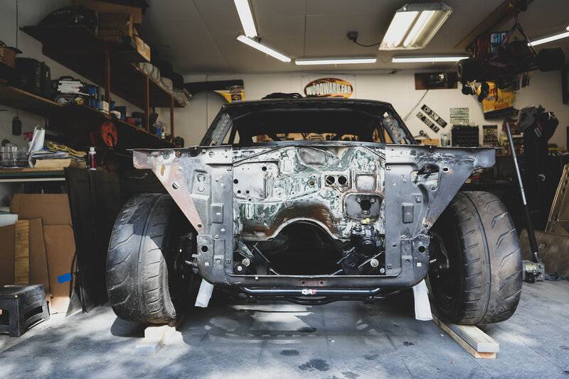

Also doing some work on the front fascia (finished it since this photo was taken) by filling some of the holes that were there for the bumper brackets, and also moving the cutline between the fender and front valance so now it is lining up with the upper fender to hood cutline.

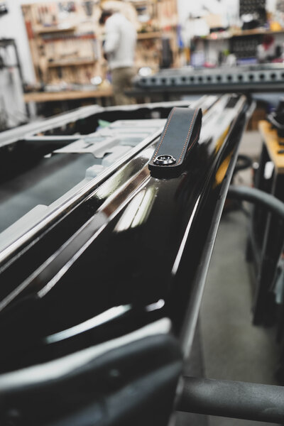

I finished welding my hood louvers, my rear valence, got the wing built up and welded, added Aerocatch latches both to the hood and trunk (panel gaps are spot on and won't change now!), also removed all the lead from the car and fixed some rust issues, welded some new patch panels here and there, built a closeout panel over the headlights, built a reinforcement / jacking up point under the QA1 crossmember, made adjustable pushrods to setup my ride height while waiting for my shocks, cut out the top of the front radiator panel to be able to pull the engine easily from the front, welded shut the trim holes and mirror holes in the doors and around the quarter glass (i won't have side windows or trim, so I wanted it to be clean).

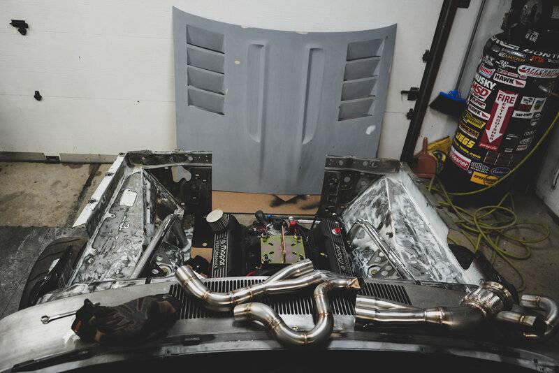

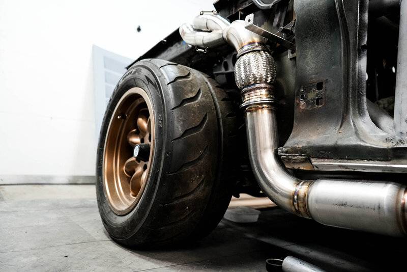

I also 3d printed my own header build kit and will build a full 4-2-1 stepped header system in 321 Stainless Steel for the car, equal length and everything. Not easy to package 22" long primaries and 15" secondaries in there.

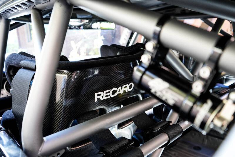

Recaro tested in position to finalize some brackets.
Laid out most of the sponsors stuff currently arrived with the exhaust tubing from Vibrant Performance and Goodfabs, the seats, the Radium Engineering fuel cell...

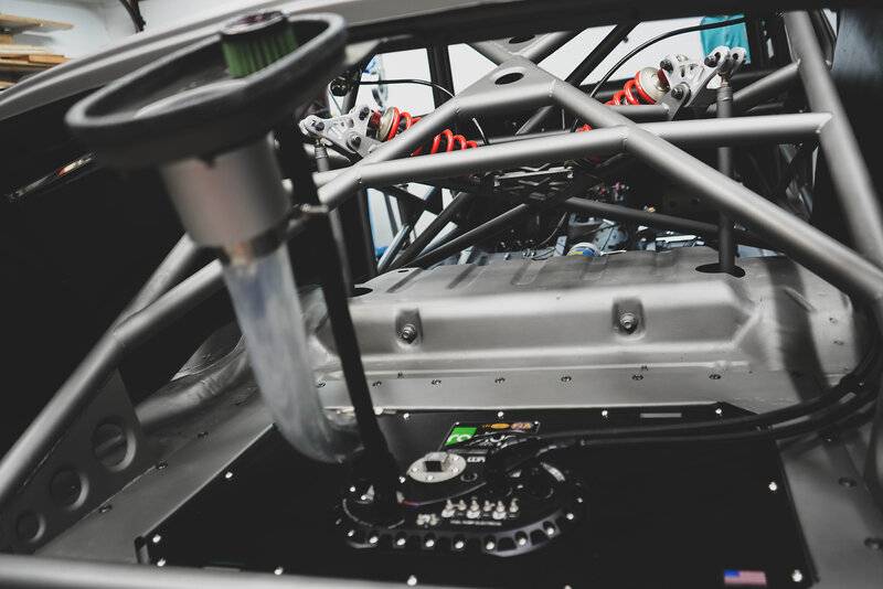

And mounted the fuel cell (2 surge pumps and 1 lift pump for an integrated surge tank setup) into the car, with the fuel fill and vent setup on a bracket under the decklid, which required cutting the decklid open and hammering a flange all around the opening so I can refuel without opening my decklid.

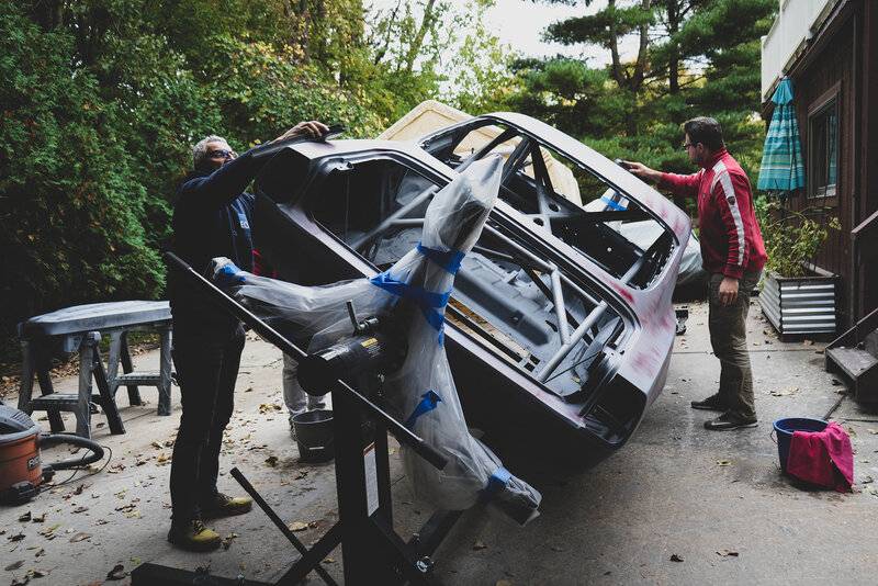

So, in the latest news, the car is coming back home in a few days. We were at SEMA 2023 last week. It's been an absolute thrash over the last 4 months to finish the car for the show. Interior, exterior, paint, widebody, suspension design & build, windows, plenty of details everywhere...
Well, here are a few photos of the last weeks of the build. Still more work to do before I can drive it next year, but we're getting close. The car made it into Hagerty's top 10 restomods from SEMA< alongside builds from Goolsby Customs, Ringbrothers and other million dollar builds. Not bad for a 2 car garage, driveway kinda build :)
