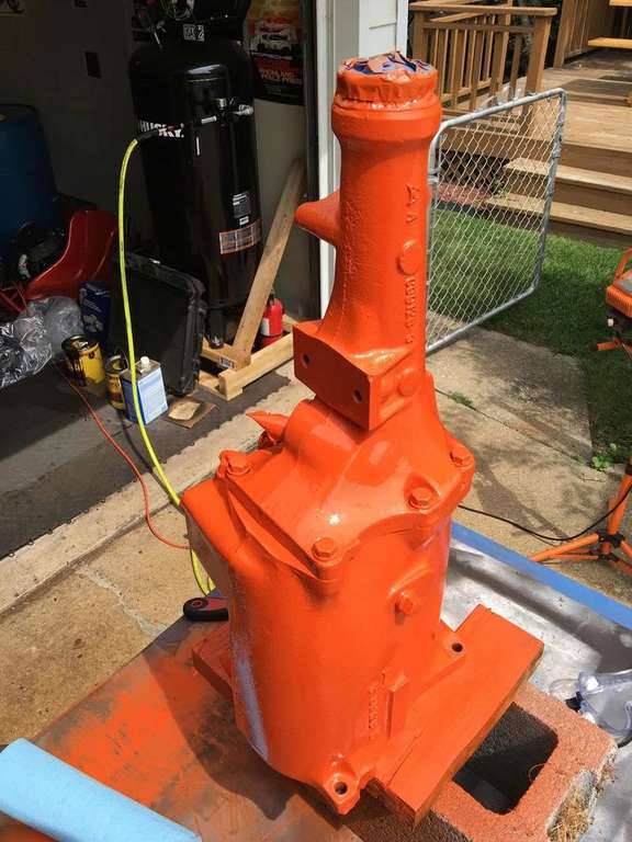

Cast iron 4 speed...Why? Those things weigh a ton.
Later years featured Aluminum housing, same trans. Plenty strong, too.
Much easier to work on. You drop this thing, you feel it, Big time.
Why? Because I could find one and it didn't cost me 2500$ like a fully rebuilt from Brewer's ... And I've got a cast iron block, heads and crank, so I'm not really at 40 pounds more or less now... oh and i'm not building a pro touring thing either so i don't really give a f... :)
When you try to discuss an issue with ignorant people, you always get a smart *** answer back.
Thank you for calling me ignorant... Like i said, i'm not chasing weight savings, and i don't have an infinite budget. If you want, my birthday was yesterday, you're welcome to send me an aluminium block crate engine and a Tremec 5 spd... Now that's being smart-*** fyi...
It's a muscle car, not a freaking Lotus Elise... But whatever.
Oh, and to be even more smart-***, my build is a 68 Barracuda, which had numbers matching engine and trans, so I'm keeping with 68 parts on the car, including the new trans and rear end. And as the aluminium cases were introduced only from 1971, that doesn't "fit the bill" for me anyway.
