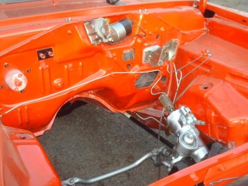

I have to install all new front disc brake lines on my Cuda. I meant to do it BEFORE I put the engine in , but I got too eager :banghead:
I got the car when it was taken apart and I don't have a visual on how they route around everything. I have the pre-bent lines but not sure where to begin.
Googled for pics , but really didn't find any that helps. And my shop manual isn't helpful.
Any pics , especially ones with the cross over line to passenger brake would help.
I know it's going to be a bear with the drivetrain in, but I'm not pulling it. Any suggestions would be helpful.
Thanks
Are you needing from the proportioning valve to the wheel? I can get a pic of my 69 tomorrow evening if that'll help.

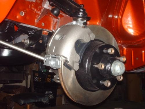

I swapped 73 swinger discs onto my 69 notch. All of it pretty much 'fell' into place. I'll get you some pics after work tomorrow when i have some daylight. Heres a couple sideways pics from my phone. Probably not much help tho..
Thanks for the pic!!
Just had an aha moment !!! First time I've seen the line on the firewall. I've been thinking it went on the underside of car. This makes perfect sense now!
Have to remember this is my first Mopar...... And it's showing with basic confusion like this... Lol
Keep the pics coming....... Thanks
