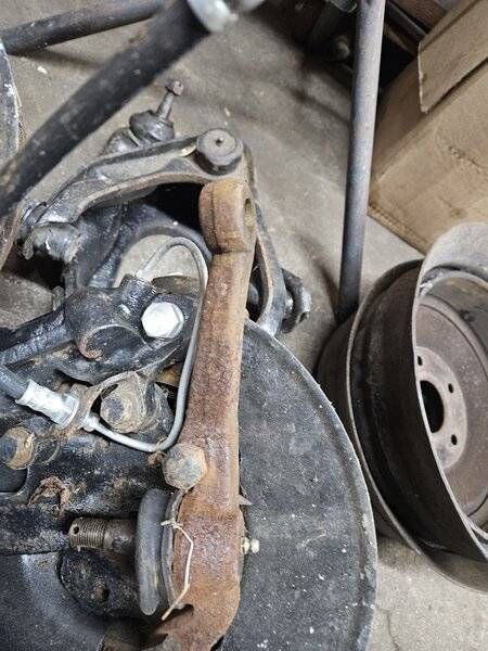

well this is todays find
same guy i got the gts hood from
he said his is a 383 car someone swapped a sb in and an auto
hes doing a turbo ls swap and a coil over front end
so hope its what i need ,came with upper control arms bjs look good bushing done but one is smoshed
new calipers one rotor looks thin....just a bonus have a disk brake set-up anyway
ball joints don't match and i guess one was left loose (left is the nicer)
think r/s is chinesse
going to do lower bushings ...never done them before..but thats another topic
i got torsen bars not sure if they are right ...funny he marked l/r ..r was in left side
a little banged up on the bottom ,but think any one will be ...should i weld up the seam on the bottom

anybody know what t-bars are used in the 340 ...
are theses the the right ones

892/893 is factory, it'll be stamped into the end of the bar at the hex.
i don't know if it's the angle but the swaybar looks aftermarket. or maybe it's just the mounts. but it looks big, so i'd run it!

.89 inch #894 383 bars
Wonder if they are going to be too stiff
Are they left and right

#894 is a RH, #895 would be the left. Not too stiff in today's world if you like a better handling car. There are aftermarket ones that are even stiffer that are popular too. There's even a factory A-body set of torsion bars that are stiffer than the BB bars........The '76 Police car bars.

So the one marked r on the back is right
So funny cause when the guy took them out he marked them ...
They where in wrong

Doesn't make a difference but usually the 983 and 984 numbers go to the rear so you can read em. Only matters that you install the left bar in the left side and right in the right side

One side stiffer than the other? No, but, they were made to only twist one direction. Put them on the wrong side and they may break.
yea so if you put them in backwords they are twisting the wrong way

Nope, the twist is the same forward or backward. Just the side is important. I know it's hard to visualize, but, if the front of the bar twists one way, the other end twists the other whether it actually moves or not. Draw a curved arrow on one end pointed in the direction of the twist. Then draw another arrow going the other way on the opposite end. Then swap ends. You see the arrows are still pointing the same direction on both ends. Swap sides and the arrows are going the other (wrong) way on both ends.
