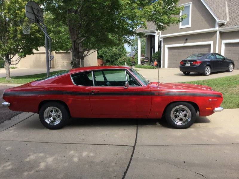

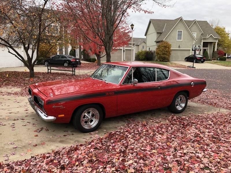

In 69 if you got the wide stripes with the call out 340 or 383 I believe no fish
Original paint car

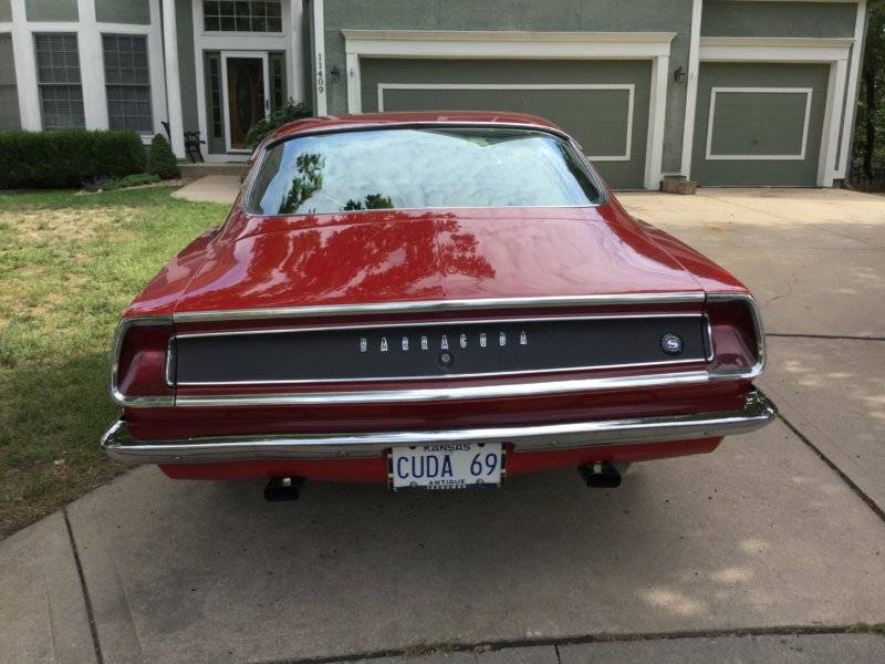

340-S formula S package black rear panel with s emblem.

Wide stripe no fish or engine size emblem.
I did the same to mine. I liked the look of the formula s so I decided to make a clone. I put the 340S emblems where the fender fish were. I also painted my rear trunk trim flat black and replaced the rear fish with a formula S emblem. Couldn’t find a rear 69 emblem, so I painted a 68 emblem black. Still need to paint the front grilles black.

Sport stripes (V6) with 340/383 callouts on Formula S no badges. Only stripe delete or V7 cars.

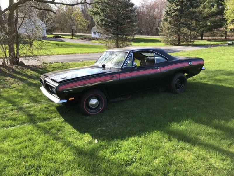

I am thinking i will just put the 340-S emblems on the fenders, or fill the holes altogether and mount em on the dart sport scoop. Or i could put put the 340S emblems on the fenders, and the 69 side stripe without the 340 callouts in the stripe. Like the stripe kit offered by phoenix graphics shown on a 68 fastback in pic below.
I have seen 69 318 cars with this wide tape stripe and no callouts in it. Probably a dealer install thing to "move the iron" off the lots. Maybe a spring special. Stripes and cragar S/S wheels ?
