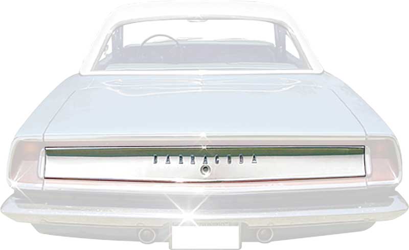

Hi I wondered if anyone has experience of the replacement rear trim panels for the trunk lid on 69 Barracudas. The previous owner of my car has fitted indicators to the panel just inboard from the brake lights, also the top and bottom edges of the panel are a bit dented, although I could probably tap them out.
The existing panel is a single piece that has the centre section that sits between the brake lights as well as the trim sections at the top and bottom of the trunk lid. The panel that is available from Summit and Jegs etc maybe looks like it is just the section between the brake lights and doesn’t include the trim sections. Has anyone bought one of these?
Yep, it's referred to as a finish panel. One piece. There are no other trim pieces. A picture would be great but those panels are around $400.
This is typically what comes on all 69 Barracudas except the Formula S version which is black and has the S medallion. You can not buy them argent or black with the fish or medallion from the aftermarket companies.

Unfortunately at the moment it seems only Jegs have them in stock although I’m doubtful that they actually do. The problem is the pictures that they all have of the panel show it as only the centre section which makes no sense as it is as you have in the picture on your post. Anyway I’ll go ahead and order it and then wait for them to tell me they don’t have it Thanks.
Sorry, Righty, your car does not have a 69 finish panel. that's the problem. What you have is the 68 trim panels with two big ugly custom lights cut into the metal. However, the proper 69 panel would cover up the holes, no problem.
I don't know what's going on with the bottom photo (message #8) — there has NEVER been a panel that was just the center section highlighted in that photo. Maybe they were just trying to show that this product had the argent finish center, as opposed to the black finish? Anyway, just ignore it — it doesn't exist.
Yeah I think you're right about the photo in the product descriptions it's not indicative of the actual product. The panel on my car is one piece, it's hard to see in the photo but it is a 69 panel with the top and bottom trims and centre section all pressed in one piece, having said that I think it has been fitted with the wrong hardware as the bottom outer corners sit very proud of the trunk itself, although equally that could be the reflectors or something on the back of the awful indicators pushing it out. I hate to think what I'll find when i take them off. Which leads onto the other issue which is that the original wiring and ballasts that allowed the brake lights to also flash as the indicators has been removed, so finding the parts and how to re instate that is going to be another puzzle. The sad thing is the car had indicators mounted below the bumper probably because it was a UK market car, why he had to put those horrible things up there I just dont get.
