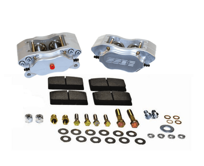

Hi, we made brake upgrade on a 69 Cuda Formula S (a friend of mine) with stock front factory discs (he didn't want to upgrade to 4.5'' bolt pattern and with 4'')
the breaking was poor in spite of new front discs and rebuild calipers
We decided to install A199-1 SSBC calipers and semi metallic pads, that fits with the factory discs
the rear brakes was modified with DBK 384 disc kit
New power assist and master cylinder from MP Brakes
The VL3359K valving for a 4 wheel disc system installed
After installation and bleeding, we are a little disappointed with the braking !
the rear is OK
But the car doesn't brake enough in front wheels, we measured about 60 Bars pressure in front
Has anyone already installed these SSBC calipers with factory discs ? what result ?
It may be a ''friction'' problem between discs and pads ? disc surface too hard ? or inappropriate pads
Thanks for your reviews

Yes, I had the same experience with them. In English we would say "they suck".
Even with a small 7/8" bore master cylinder they produced no stopping power at all. It has nothing to do with the pads or bleeding them properly. The problem is that the pistons are too small and do not provide enough clamping force. The pistons in these calipers are actually smaller than the factory Kelsey Hayes 4-piston calipers which were not that great to begin with.
I even drag raced my car with these a few times and it was an adventure trying to stop the car. I was only going 12.0 @ 111 mph in the 1/4 mile and I always had to use the last turn off. There were a few instances where I had two feet on the pedal trying to get the thing slowed down. They also wouldn't hold the car against the converter at the line so I could only launch the car from just above idle. Normal driving on the street was marginally better.
I got rid of the whole system several years ago and replaced them with Wilwoods. I would never recommend this particular SSBC system to anyone. It's a nice idea but the performance is not there. SSBC should re-design the calipers to accommodate larger pistons or just discontinue them.

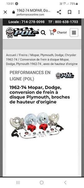

we looking for that kind of kit

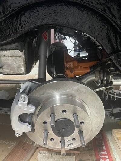

For many years, I decided to install rear disc brakes, that I do with MDRC01 RS kit

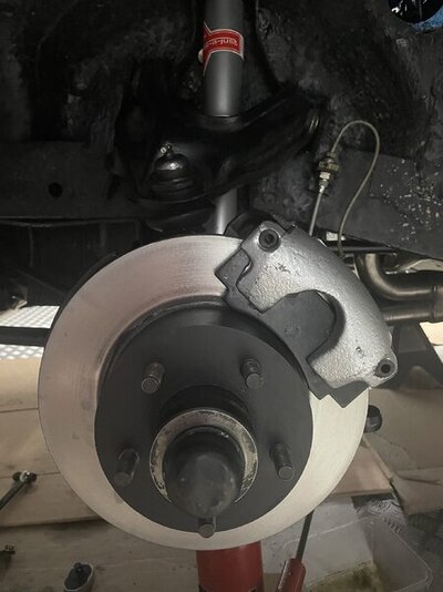

For the front disc, I bought a rebuilding kit for 70 mm caliper after 20 years and control all the brake system
i shortly have finish but I had a problem with a damaged bracket caliper thread
it's in process to solve that
