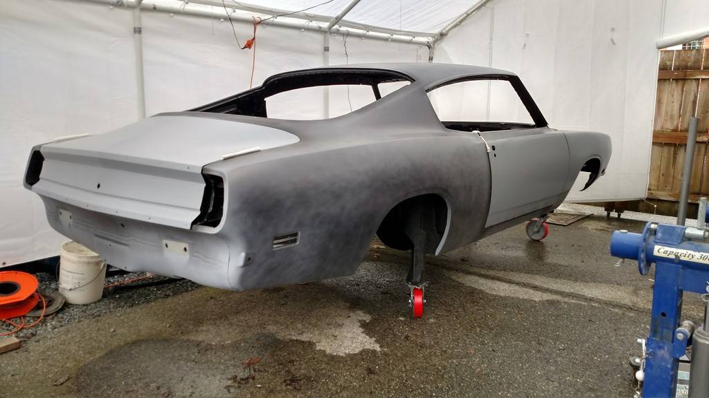

Just looked again. No Holes... :-( It is also AMD...
Nutsert, Rivnut, Threadsert... whatever those little bastards are, I'm going to give them a go. :poke:
Need measurements please... Not just no screw holes but no holes at all.
Guessing they decided to make it one valance fits all years? 67, 68 and 69?
Mo6Bc1M0v-h55oxbuBYVdwAXI4M7hz8lK8m8RlCxhpAbYzlmjOrJjzcxfpOFeBUufnPzYXJhuvH2BUkcW=w3262-h1835-no.jpg
Not even the openings for the bezels! Did you order the correct piece? Looks like a 68.
And too many think 67-69 were interchangeable. Not quite the truth. 68 were the best, but when you a own a 69 you deal with it. One year only and lots of changes just to become an E-Body.
I put an AMD panel in my 69 about 5 years ago, and it didn't have holes either. At the time, I was told that my choices were with the two tailpipe extension "slots", or without them. It took a while to figure out backup light housing placement.
Oh well, guess I'll be drilling/cutting... par for the course.

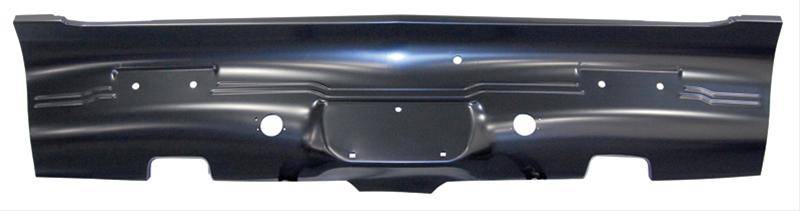

Shows holes. Got mine from Tamraz but same thing on Summit...
Bought back in may 2016
Guess I missed the not so fine print and just looked at the picture.
Notes: Rear valance features rectangular exhaust tip cutouts.
Will fit 1967 models. Backup light holes must be cut for 1967 and 1969 applications.
AMD PN 960-1267-T

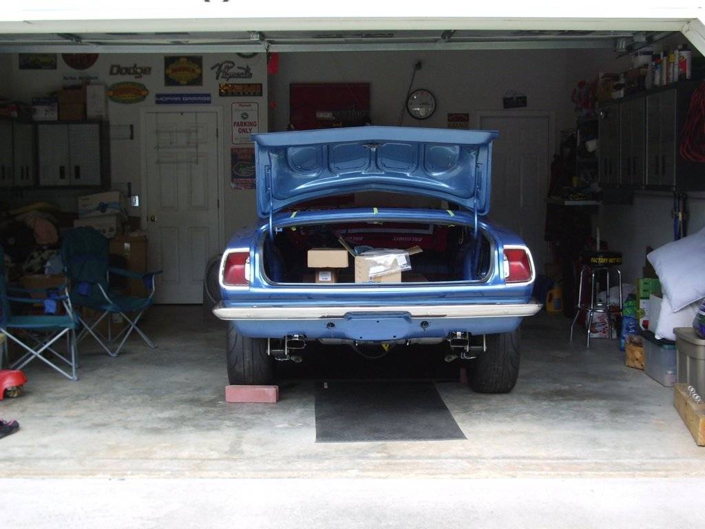

If you want I can give some measurements based on AMD design, guess it may not be correct though yes!
Will do! The car is back in the garage after hibernation for Christmas lights. Tell me how you want the measurements.
Hard to measure but 1- 3/4 to 1- 7/8 from bottom edge of valence to bottom of the bezel. 19.5 center to center of the bezels.
A: Center to Center 19.5" :thumbsup: Got it!
B: Can you measure bottom edge of Bezel to bottom edge of the Valance as shown?
I'm thinking this would be more accurate.
Thanks!
