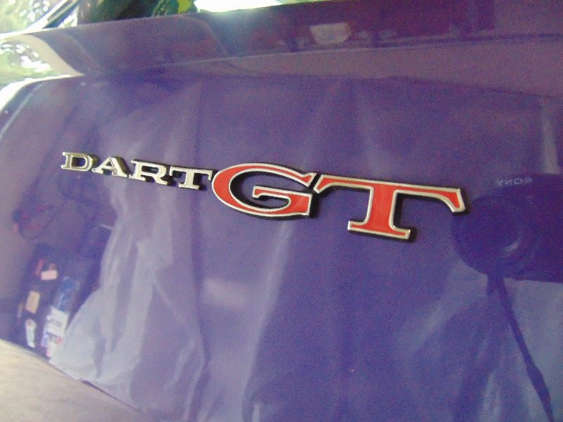

here's a picture of the Dart GT emblems. Same as a 1970 Dart GT but in a slightly different rear quarter location. Repops available from Layson's Restorations, a vendor member on FABO...
@str12-340: Thanks for your reply. I ordered replacements from Year One only to find out that they are on back order. I called and they said that they should be in by the end of the year... we'll see. If they fail to come it I will look at Layson's, thanks.

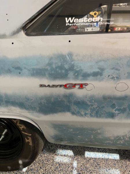

Did anybody send you pictures of the 1969 emblem location? I know that it is significantly different than the 1970 location.
@str12-340: I haven't received anything other than what you see here in this thread. I would like a good picture of the #79 decal if anyone has one. I don't think there are too many 273 four speeds out there though, unless the automatic used the same #79, not sure. I'd also like information on the locations of the other decals like the jack instructions, coolant, and tire pressure. There's a lot of variation online which is why I ask. My car was built at the Hamtramck plant, so ideally someone with a car built there. Thank you.
Pins are accessible with the rear panel removed and the quarter window rolled up. Should be able to peek in there and see where they were filled.
