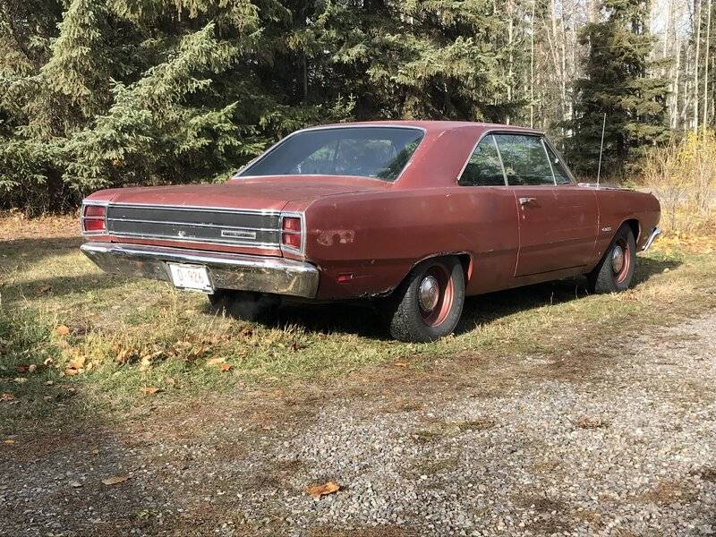

14x6.5 on the rear, they used to be chrome but are now body colour.
(Just answered a similar thread Q here a few weeks ago).

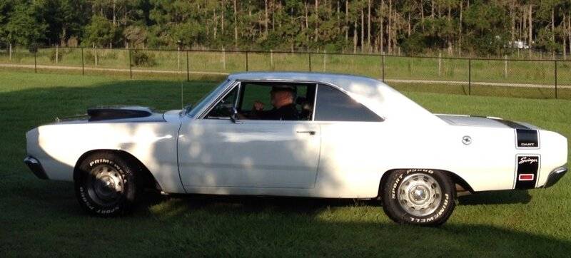

69 Dart had 14s SBP, upgraded to front disc's and 15 in wheels, Large Bolt Pattern.
Aftermarket magnums, (forgot the actual rim widths).
For rears.
For fronts.
