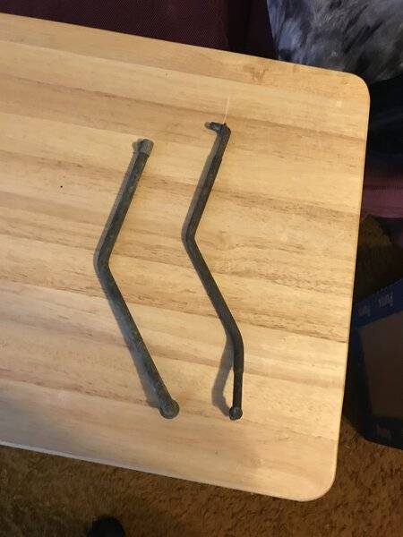

Guys need help again seems I have a hodge podge of linkage on my Dart 70 340 727 of course anyone have a set up they can part with? Mainly need the parts up top rod and linkage at trans is ok throttle pressure/kick down rod is cobbed and the bracket that bolts to the intake anyone? Thanks. Brett
Brett, post some pics and I’ll see if I got pieces to help u out. I may have everything u need if a guy passes. Kim
Sent you a pm
Yes, u have the 340 bracket and rod up top. What do u have for the down rod, and lower rod. Can u get a pic of them and a measurement? Is the lower rod like the left or right rod. Left is 727. Kim
The bolt in the kickdown rod slot indicates that the rod is too short. Edelbrock make something for that to ensure correct travel (and the no cobbled together look). Look up Edelbrock part # 8004 (5/16ths inch threads) or 8003 (1/4 inch Threads) - simple elegant solution.
