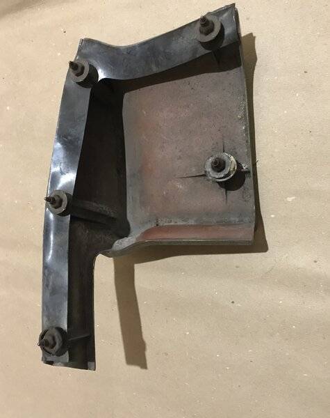

I had (2) 71 darts - drivers then parts cars. Only one had the gaskets (hard plastic) on both front and rear extensions (pic above)
My 70 340 dart only on the front fender extensions
All of them had seam sealer on mounting nuts

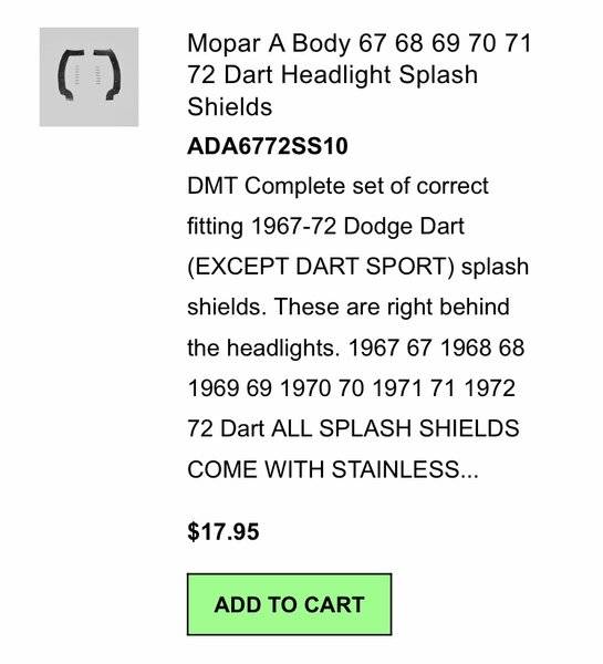

Detroit Muscle Tech looks like they offer them in one of their gasket packages
I’ll try to post a pic of it here
Here it is. For the front fenders only
Wanted to talk to them last 2 years @ Carlisle but they weren’t there possibly due to covid? Maybe this year
Just wondering if anyone is using them or seam sealer in place of them and under the mounting nuts
So the car in my avatar was bought new by my father and I got it from him in 1975. When it came all apart for its first paint job there were no gaskets front or back. In 1983 I bought a 70 Swinger with 27,000 on the clock. In 1998 it came all apart for its first paint job - no gaskets front or back. The 70 GT I'm working on now was wearing its original green paint and again when disassembled no gaskets front or back. I've pulled several other 70 Dart front ends apart for parts and have never seen them.
Maybe it's a 71 thing??
Could be a 71 only or late 70, my 70 build date is 6/23/70 and it had them with both extensions front and back which are diecast but the gaskets are brittle with age, now in pieces
