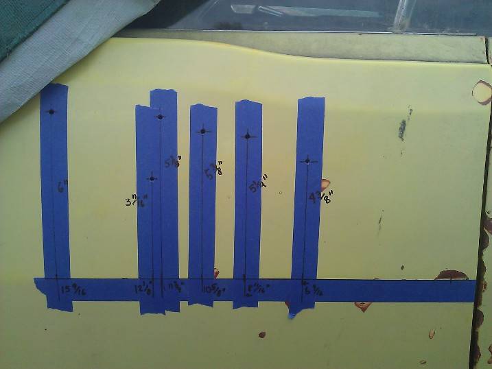

I am starting to cut and buff my car and test fit emblems and I had the quarter panel emblems in place.

And another one... I measured 2 and 1/2 from the body line to the top of the a in Dart and 2 3/4 inches from the top of the flower to the center of the body line sweep.
I honestly forget how I did it . I'm sure I came here and found a pic like yours it may have even been yours? :thumbsup:
Thing is you cant measure drivers side and transfer it right unless you reverse the dart emblem holes the pattern isn't the same "Dart" is to the rear on pass side and to the front on drivers side..ah the details.
Well I've had my car over 40 years and never noticed that LOL but you're right!
