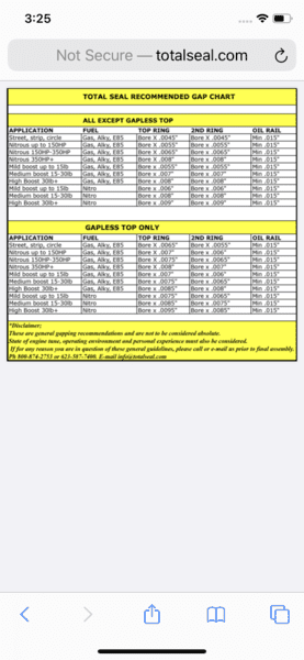

Luckily it appears the pistons were all that was hurt. The rings were gapped at .022 top and .024 bottom. I'm thinking this was too tight and the rings butted together exploding the tops of the pistons. Everything else looks good so I've ordered new pistons and will gap the rings bigger. Any suggestions on the gap? This is 10 lbs of boost.
Here’s a guide you can use, there maybe other charts that you can use. Just google ring gap for boost

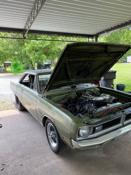

Here is a current picture. Finally converted to disk brakes up front this winter which was part of my weight savings. The HUB on the wildwood Brakes was too big for my front steel wheels so I switched to these American racing rims (More weight savings). I don't mind the new look but someday I'll probably want my steel wheel look again. We'll see.

130 in the 1/4 mile with drum brakes....
They work well when adjusted properly!
I like the “new look”

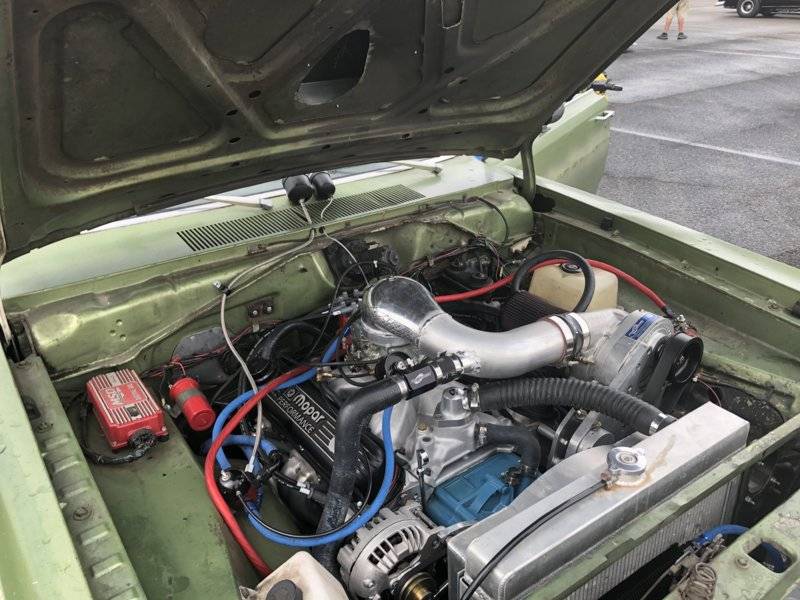

Last night went good. New Brakes felt good and held the car good on the line lock during the burnout. Only made one pass and it went 6.60 @ 105 on a very conservative tune. After that pass I realized I haven't run the valve lash since break in so I need to do that before I make another pass. I think it will go 6.30s as I start to ease in another degree or two of timing later. That should be good for a 9.90s 1/4 mile pass before Drag Week I hope...… that is if we still have drag week.

Looks like it’s progressing well and making damn nice power.
