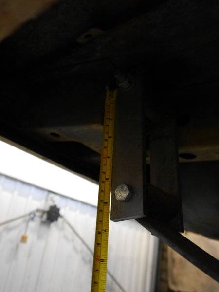

So next up is the sagging rear end. Thought it best if i empty the boot/trunk first. well that gained a couple of inches! The PO has made some longer shackles that are 5 1/2 between holes, what is the stock length I'm guessing about 2 1/2" ?
Not sure if the springs have gone soft or its the fact the longer shackle is now leaning back towards the bumper and effective making the spring longer.
Photo below is with car jacked up so shackle hanging down.
What would stock height to the rear wheel arch be?
Im going to replace the rear shackles and bushes as they dont look centred properly. The passenger side is slanted over slightly and the bolts dont look centred I suspect its just a plan threaded bolt the worng size through the spring eye.
I can get the bushes in the UK so if someone could confirm shackle length between pins I'll make my own shackles. thanks
You can make your own, however rock auto sells em fairly cheaply. Not sure of the exchange rate however AC Delco $18 and change per shackle and bushing kit
Yep, you are right, it's not worth making them. Thanks for link. Just ordered from Rock Autos $60 for a pair including shipping and taxes to UK, they arrive 5th June. So I'll think of something else to fix in the meantime.
You could probably get a spring place to arch your springs and possibly add a leaf to get an inch or 2 of height back in the *** end the right way.
I dont recommend dropping front nore than maybe 1 to 1.5 inches. Otherwise you get into a situation where the upper ball joint can pinch the spindle under compression.
