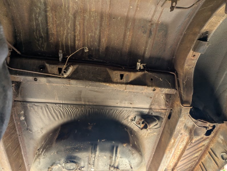

Decided to go with Roll-bar & Chassis black, this is a driver not a show car.
Y'all that posted photos of your projects, thanks! Gives me motivation and its cool seeing others doing what I consider the worst part of this hobby, rust removal and body work.
Good call, I haven't painted the engine bay yet and I still have to remove the old /6 suspension for the new/restored V8 stuff, I am planning on doing suspension mounting points and the front frame rails while the K frame/front suspension is out.
Eventually I'll have the whole underside done like that. not sure what to do about between panels and inside the "frame rails" most folks on the YT use some kind of encapsulator. Been looking at them, haven't decided on which one to get, Eastwood's platinum rust encapsulator looks promising.
something like waxoil inside any cavities will protect those 'blind' areas. they have a long thin application tube with a 360 degree nozzle on the end. you push the tube in as far as you can then spray while slowly pulling the tube back out. repeat all along the chassis etc etc.
neil.

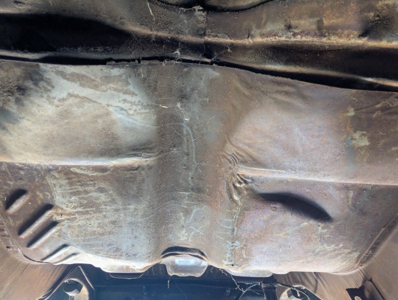

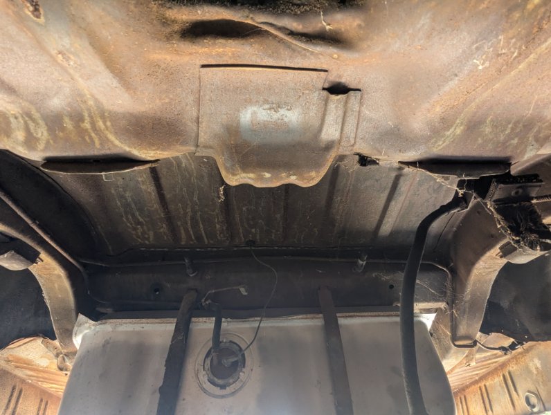

Got to work on the Dart a little more Sunday, the angle grinder almost got me and I ran out of primer so I didn't finish. Just a mix of wire wheels and media blasting.
Black aluminum oxide from the local HF, they claim its 70 grit. I hate the mess but it does a good job.
