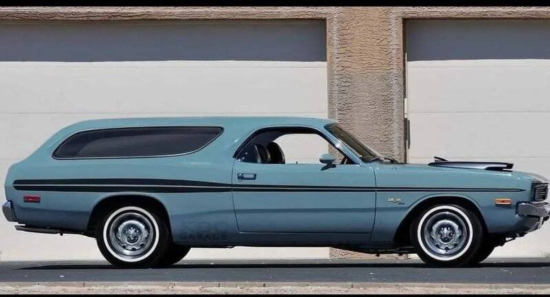

Personally, if possible I would've left the length of roof as is in original location and just attached the sail panels back farther.

Yes, roof is welded in place. If I moved it forward anymore the top of the window looked wrong. . I don't like the look of the Demon myself.
I like the way yours is lookin. I would work a small triangle piece in on either side straight up from the back of the door opening. That way you won't need a small piece of glass there. I think you can make it work. You could even use the door glass opening for the light blue wagon above as a template and do it like that. It looks pretty good!
Ya. I plan on closing out the small rear window area with sheet metal. I'll have to go with lexan for the door glass. Already busted 2 trying to cut/reshape the tempered glass. Just can't be done with what I have to work with.
