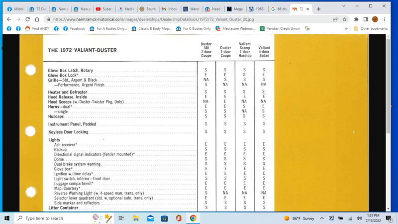

Question for the members....did a 1972 Duster possibly come equipped from the factory with the dual hood scoops ?? My understanding is that in 1970 and 1971 a 340 Duster didn't come with the scoops only the twisters ?? I'm trying to find out if the 1972 Duster came equipped with them ??
Thanks in advance for all input.
Bennoel
Yes a 72 twister came with dual 71 demon scoops
"Hood scoops with Duster Twister only" Dealership Data Book. Hamtramck website: https://www.hamtramck-historical.co...lershipDataBook/1972/72_Valiant_Duster_20.jpg
