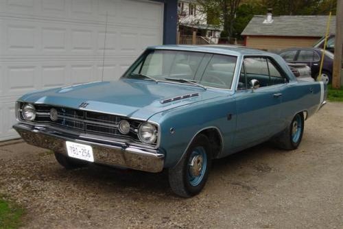

Is it the original?
The 340 was pulled from a 65 Valiant. It was obviously not original to the Valiant. I haven't checked the numbers to see if it corresponds with the Dart. That sure would blow my mind if it did!
I am storing the 340 for a friend that may or may not use it in a 65 Valiant convertible.
