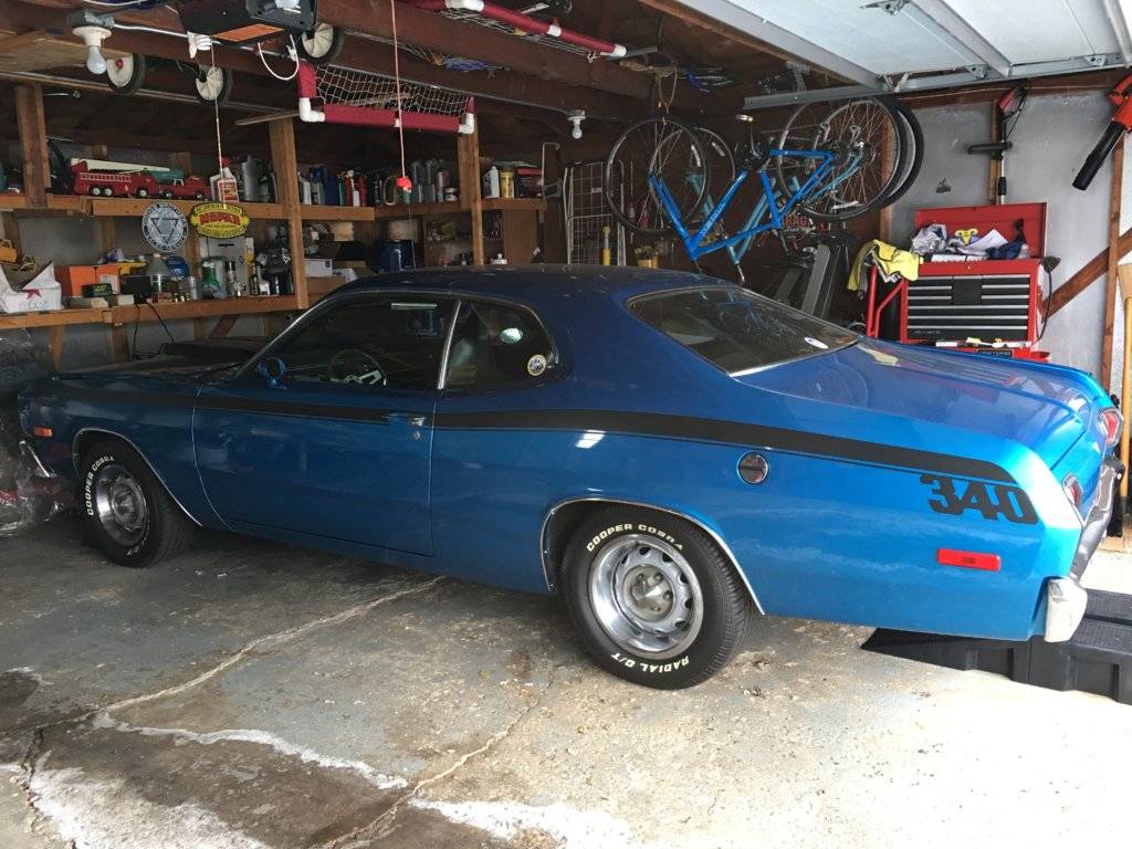

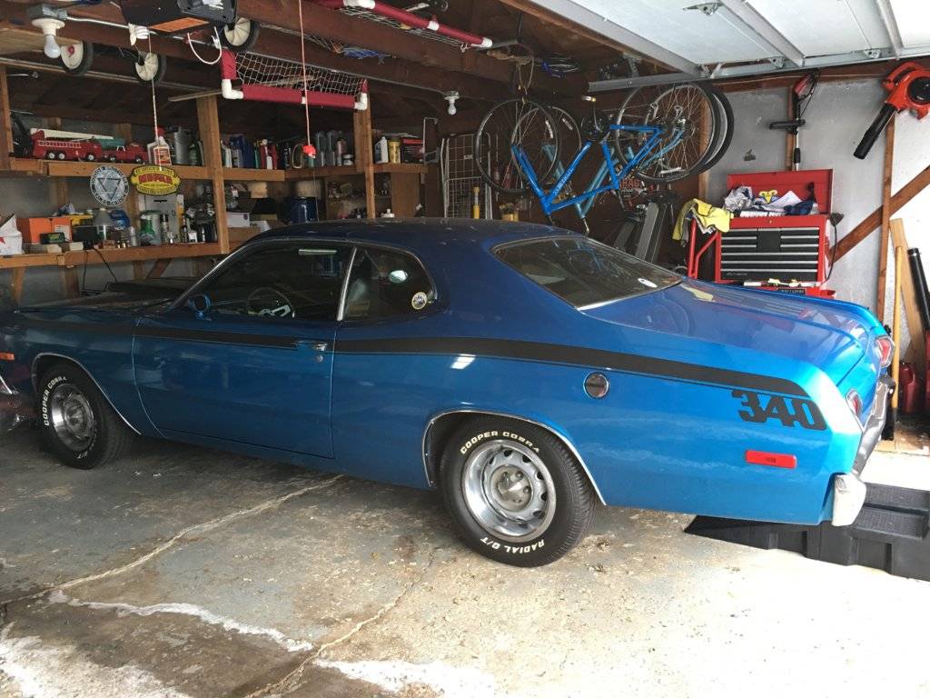

Photo from today sitting in the garage from the back side view seems to sag.

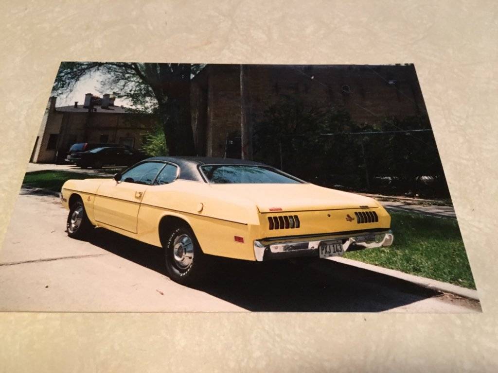

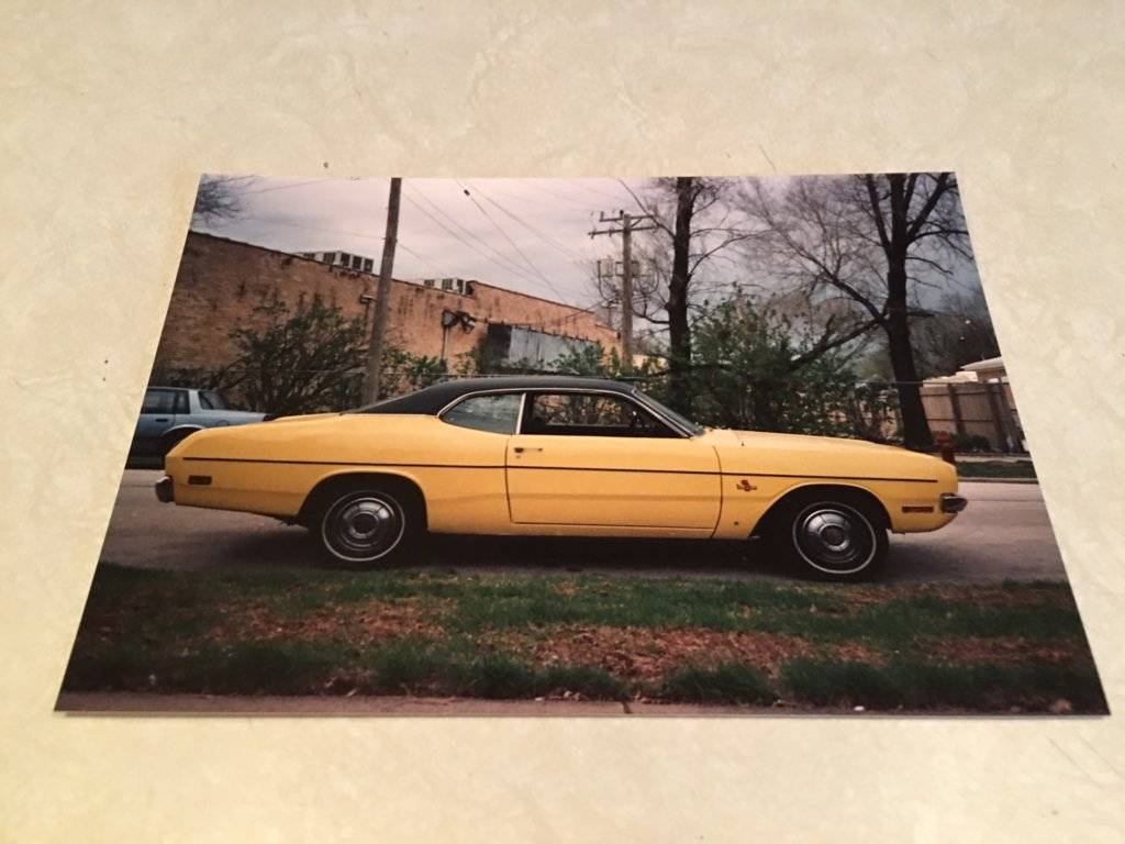

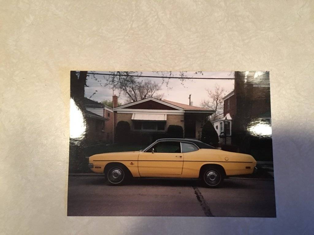

Looking for the stance of my first car ‘71 Demon 318
personally i think it looks great the way it is.. how about a 15" rim and a taller tire? may give you the height ya want.. i wouldn't go any more then a +1" spring on the car..
235/60-14 is like 25" tall.... a 225/70-15 is a hair over 27' tall... theres an inch in height right there..
Exploring my options. I have a deep 727?trans pan from Mancini that hit bottom once stepping very slow from my driveway to street cause it’s a low curb. Not a normal driveway graidient low angle. I have a new Mopat Performance pan for the spring to but on that’s not as deep as the Mancini one.
Just that that there virtually no arch to the springs and they appear to be original that time replace to restore the height.
The 15” rear rim and new tires is an option.
