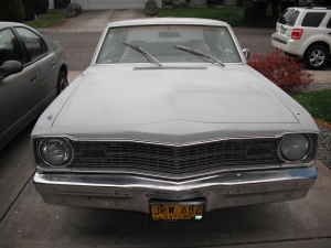

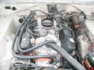

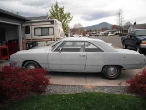

I recently found this 1973 dodge dart swinger on craigslist for 2200.00. The ad said built 360 and TF904 so i decided to go look at the car. After some thought and alot of time crawling around the car i shot a 1500.00 offer which i thought reasonable, After about 20 min of thinking it over he took it and i drove her home. Now ive had the car for a few days and see a few problems such as the trany wont move in 1st gear and it takes off in 2nd.
Im looking into the trany issues and ill post more pics when i get time.
