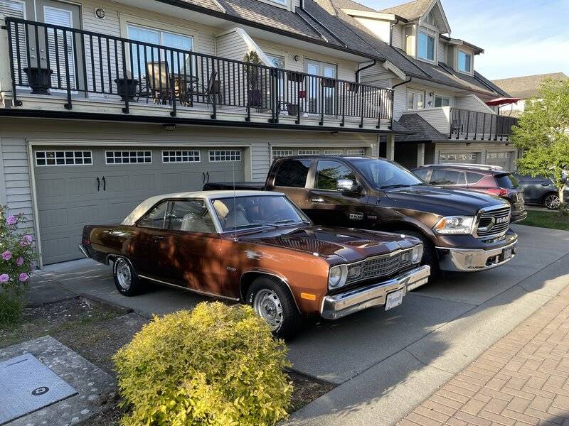

Im running 235/60/14 on all four corners of my Scamp. Have been for over 16 years on stock 14x6’’ rallye rims.
