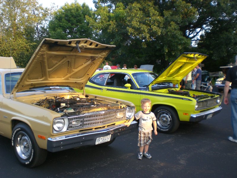

With 225/60/15's and a 4.25" backspace on 15x7's with the 73+ disks I was pretty close to the rear corner of the fender opening on my Duster. I'm sure I could have cleared 26" tires, but frankly I don't think anything much taller than that would have cleared.
img_1550_zps77c5efc4-jpg.1715437172
