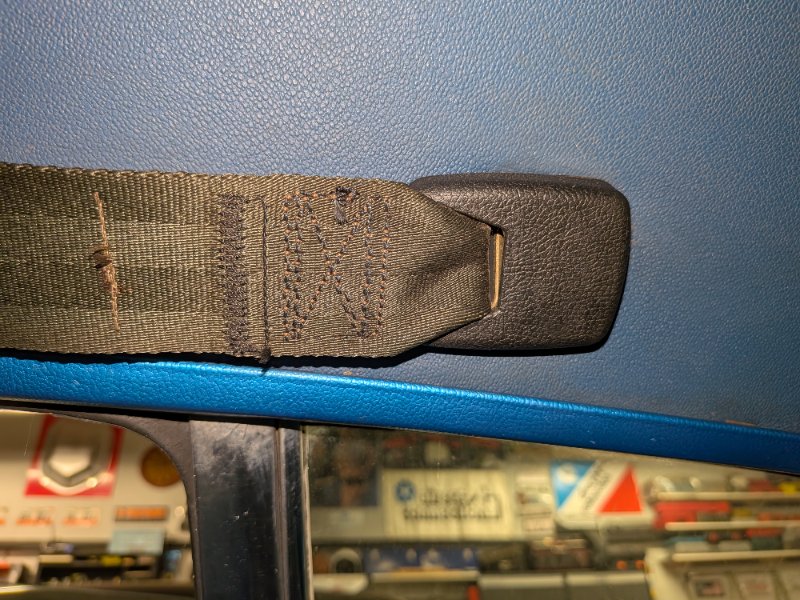

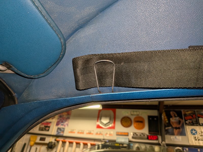

I am working on a 73 duster for a guy & he wants to put the original seat belts on the go above the door glass on the headliner. Anyone have pictures.
The following images show the shoulder belt, on the passenger side, in my 1973 Duster. The belt and headliner are original.
