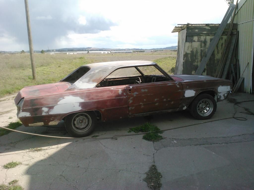

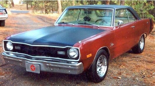

Pic from June, 2000.
This car has been in ten different iterations, five of those while I owned it and at least 4 of those, while it was in the middle of the build.
I grew up in this car in a manner of speaking. My best friends mom owned it, then sold it to him to drive for high school. As teenagers, we raised all kinds of hell in his car. My buddy eventually found a 71 to play with and sold this old 330,000 mile burnt up Swinger to his Dad. I in turn bought it from him and drove it a bit until parking it in a shop I was renting, saying to myself, I’ll go get a junkyard 360, drop it in and finally have the fast cool old muscle car I never had. Even though these cars were daily drivers, life was all about drag racing at the time and I wanted to finally be the fast kid on the block.
While hanging out in the circles of proper young, beer guzzling, women chasing drag racer guys I stumbled on too good of deal after too good of deal. A shortened 8 ¾, 4.10 geared, forged axles, mini spooled rear end that I just couldnt pass up. Well that “good deal” led to having to cut half the car apart to fit it in, deleting the rear seat (which was fine by me at the time - weight savings and all that), ditch the fuel tank because it came from a fuel cell car, and generally starting the transformation into a pro street styled build instead of a simple engine swap.
I got the 360 from the junkyard and from the same guy the rear end came from, he gave me another good deal on ported aluminum heads and a built 727 tranny. The engine got built and balanced, the decent 904 I had already built tranny got replaced and sold, and the race car build really went to another level. Bigger fuel lines were fabbed and ran and the sub frame was connected.

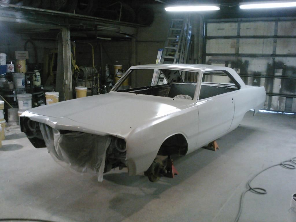

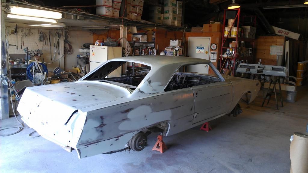

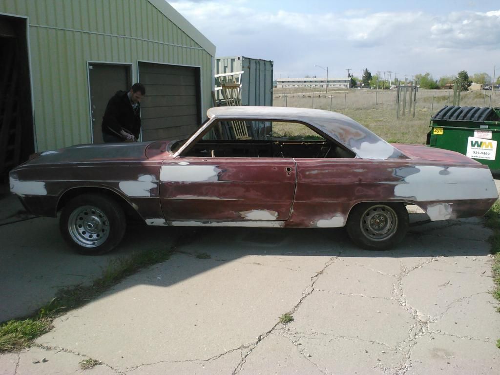

Now we could start getting somewhere

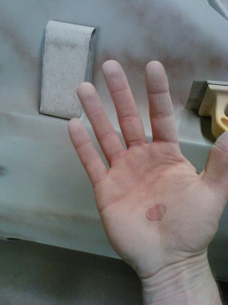

Important lesson, always wear gloves when block sanding

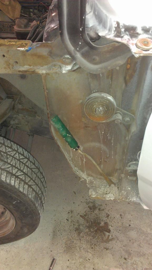

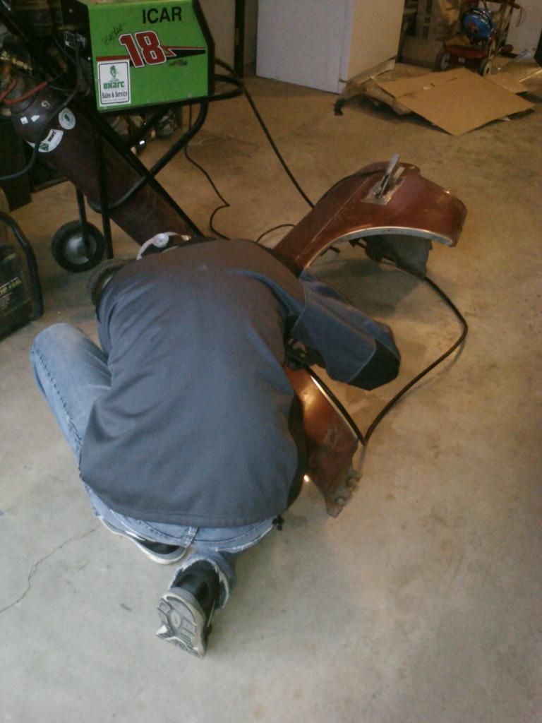

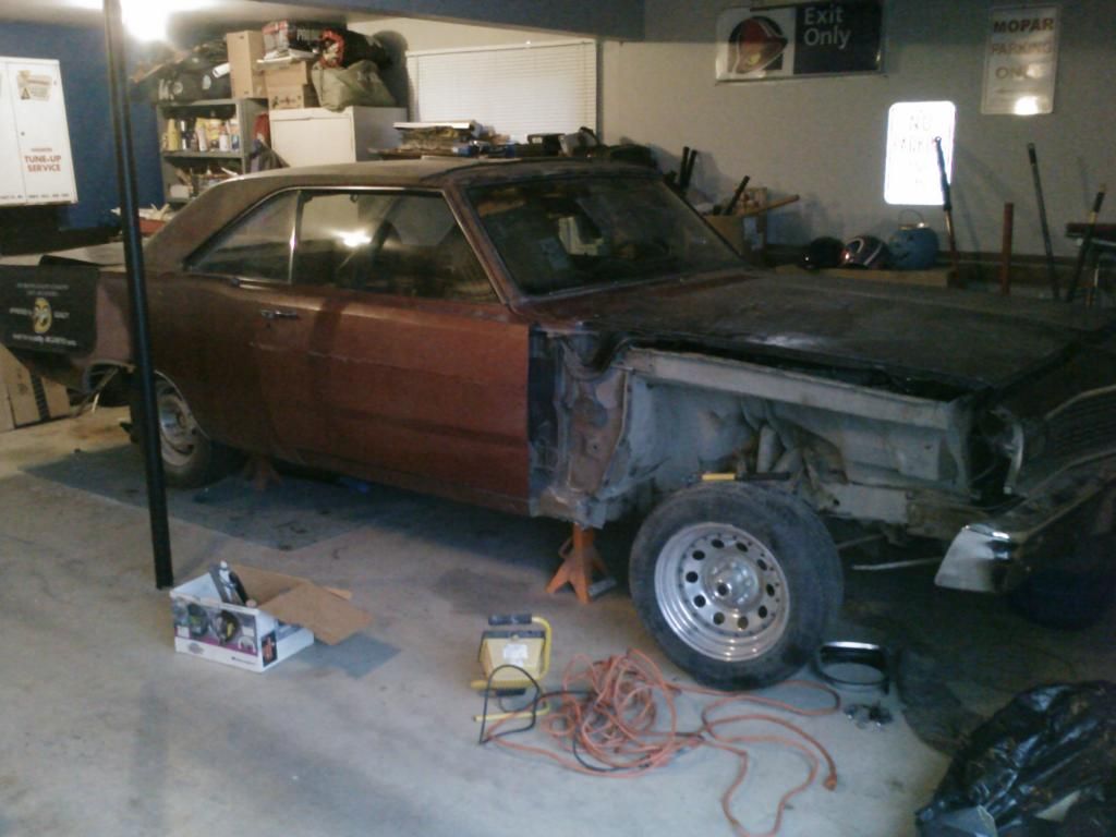

Found a "tool" from one of the previous owners when we peeled off the fenders

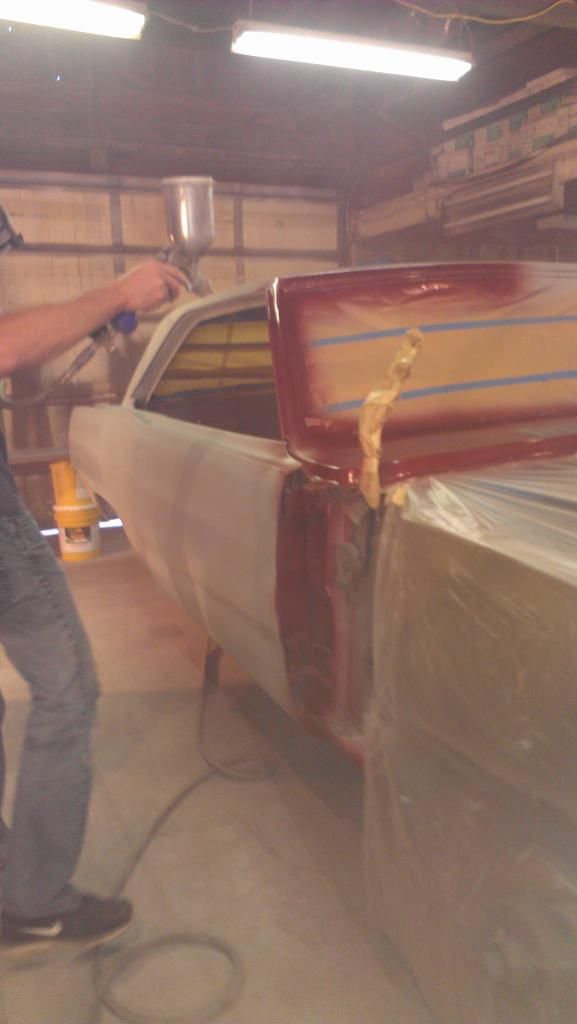

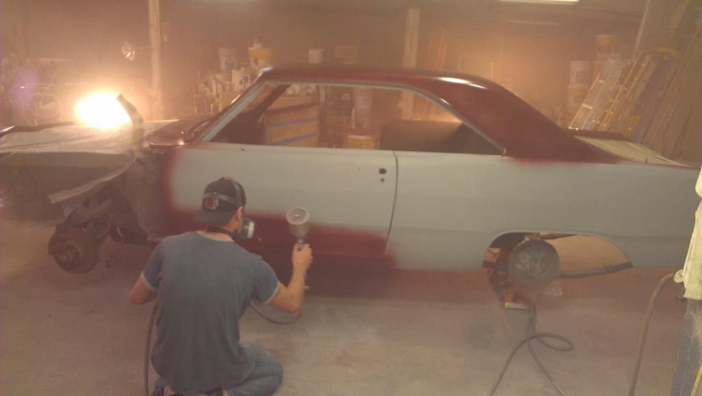

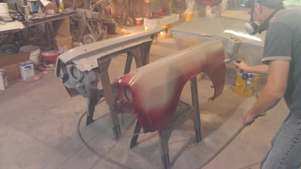

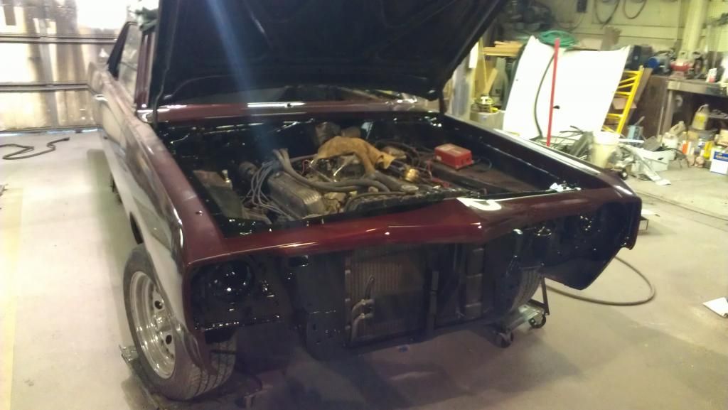

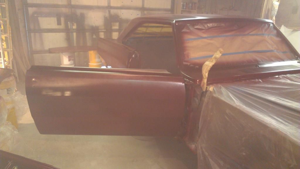

I liked the original paint scheme it had and thought that a nice blood red would fit the image and feel of the car so thats the direction we went. Again, this is no show car so dont pay attention to the lack of paint booth...
Red went on nice, clear went on really nice... got a little foggy though.
Looking forward to watching this girl grow....
I found an easter egg in the same spot you found the tool hahahaha
Due to where we were working, we decided not to buff it out yet.

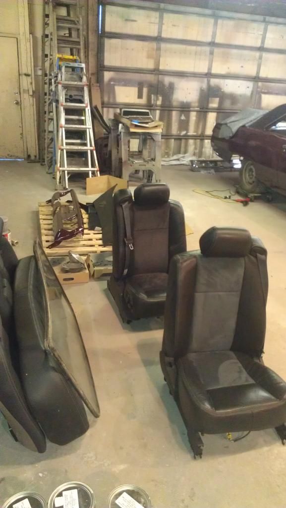

Seats came in off of an ebay auction. 05 Cadillac CTS.
Seats looked great in the ad pics but once I got em here, they had a couple rips, piling of the suede on the drivers side and what I could only hope was nail polish spilled on one. Found a good upholstery shop and they fixed me up for a good price but the "good deal" I got on them went out the window after repairs...

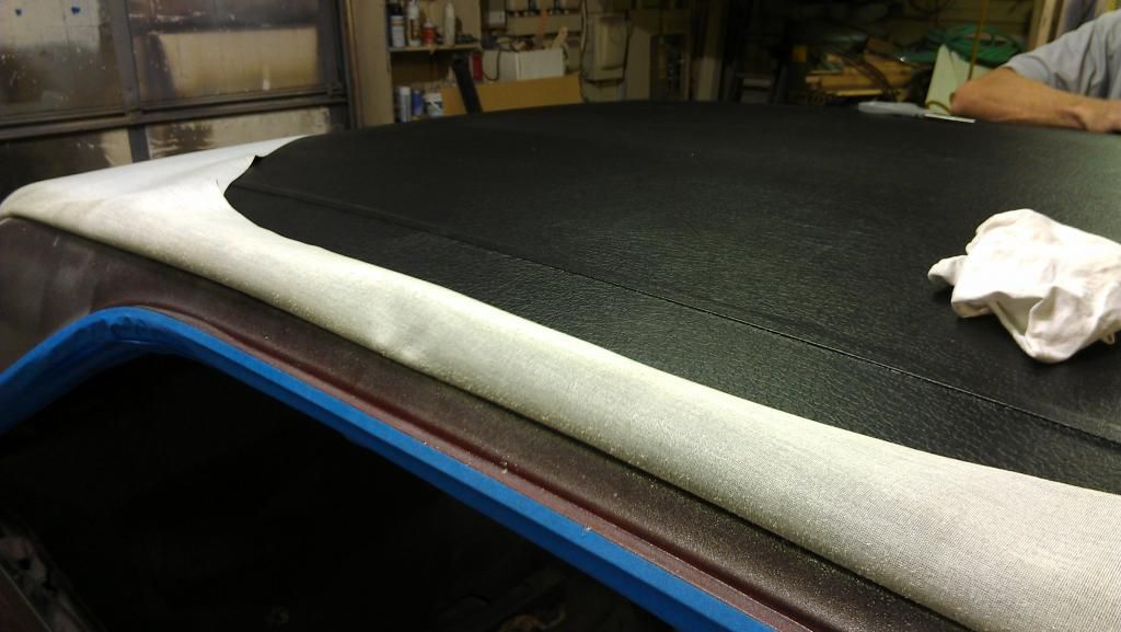

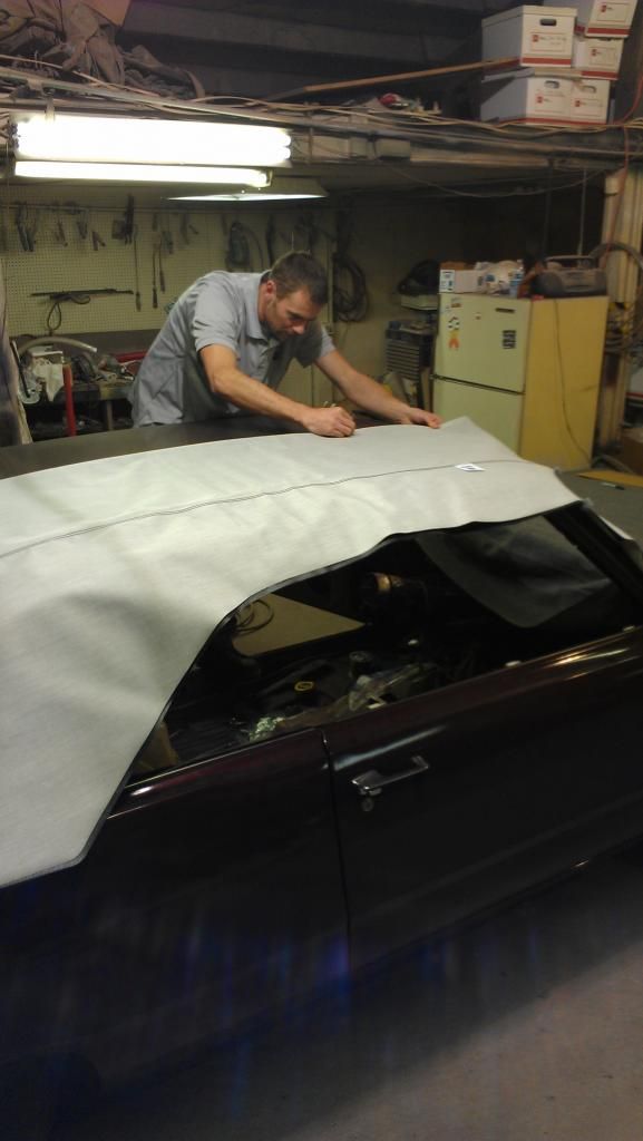

I honestly really liked it without the top but we didn't prep it to not have one (deleting mounting posts) so a new one went on.
A nice smooth top is hard not to appreciate

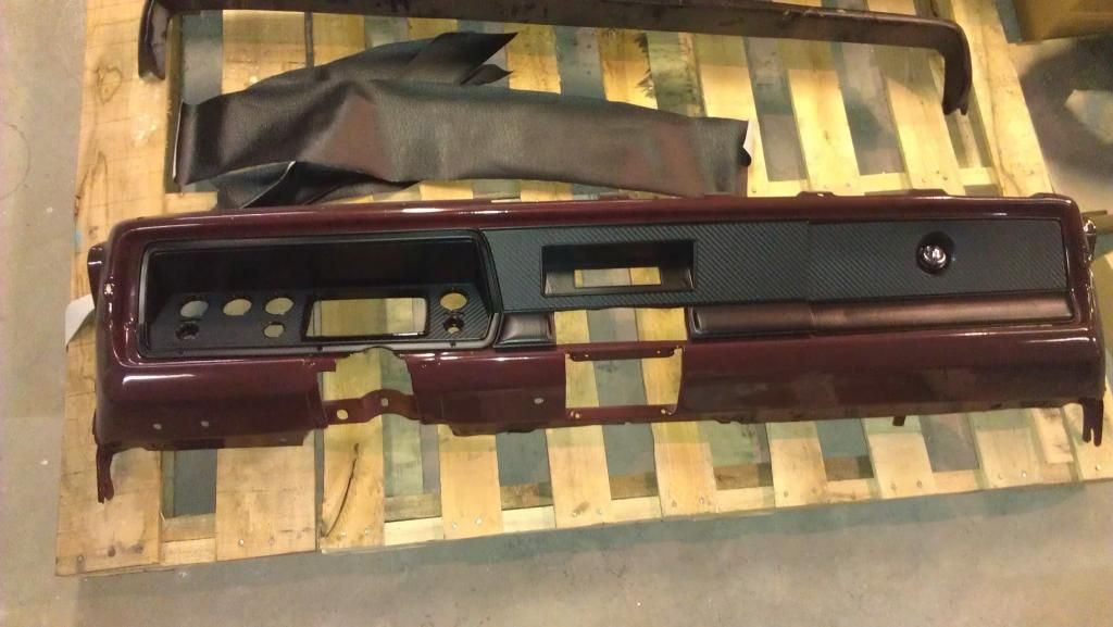

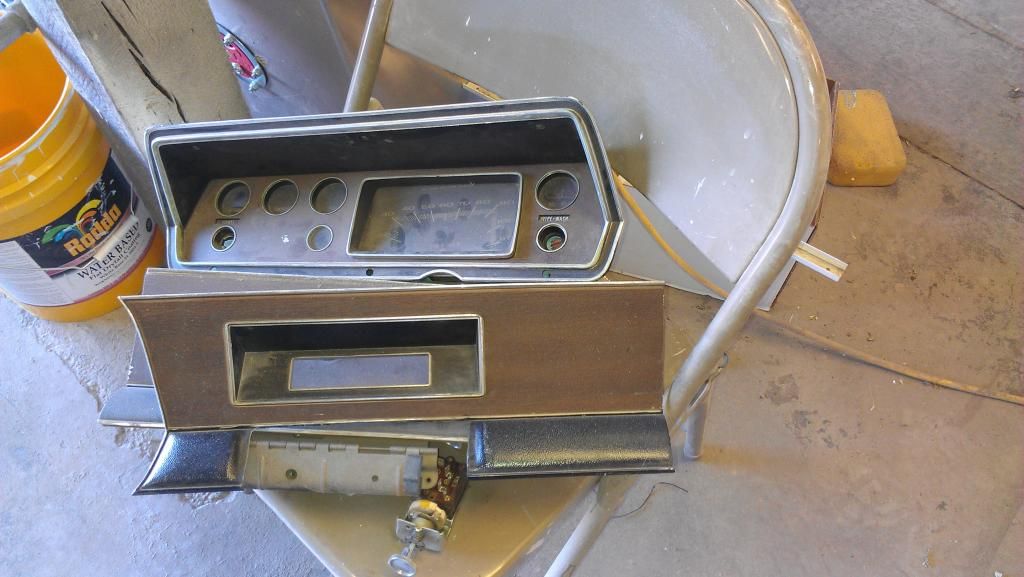

Gauge cluster needed reworked but I didnt have a grand to drop on a new dash or inset panel and all new gauges so..
from this:
to this:

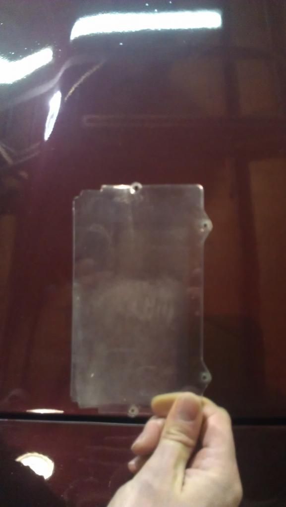

clear plastic all got buffed too. pic doesnt do the difference justice

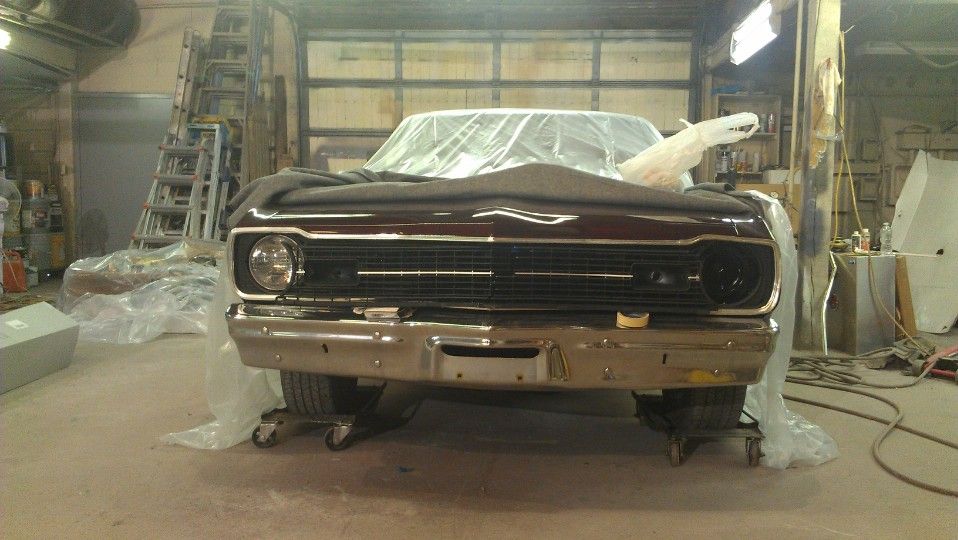

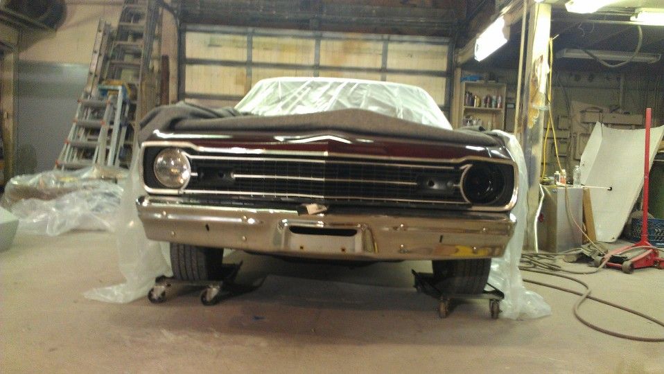

Putting the front bumper on was honestly a little ho hum for me as it went from being a cool muscle car back to that mid 70's beak car that somehow reminds me of a pimp's Lincoln Continental.

Seats came from a caddy CTS-V. really nice, really comfy, really cool seat warmers... also really heavy, really concerning with the airbags in them... :)

Also from another thread I finally figured out why I dont like my grill. It just looks incomplete somehow. So after seeing this: http://forabodiesonly.com/mopar/showpost.php?p=1970217912&postcount=57
I grabbed my old cracked grill and spray bombed it to match my current flat black one, but also sprayed in some gray metric accents. Dont know which version I like best.
Went from this:
to this:
Basically outlining the whole thing and doing the middle horizontal rib. But then thought it was too much and backed it down to this:
The middle left side rib right broke out when it fell off the car for the third time as I was balancing it there to get a quick picture. You still get the idea of what it would look like anyway. Glad I never trashed it before now so I could do these mock up changes. Still not sure which version I like the best.

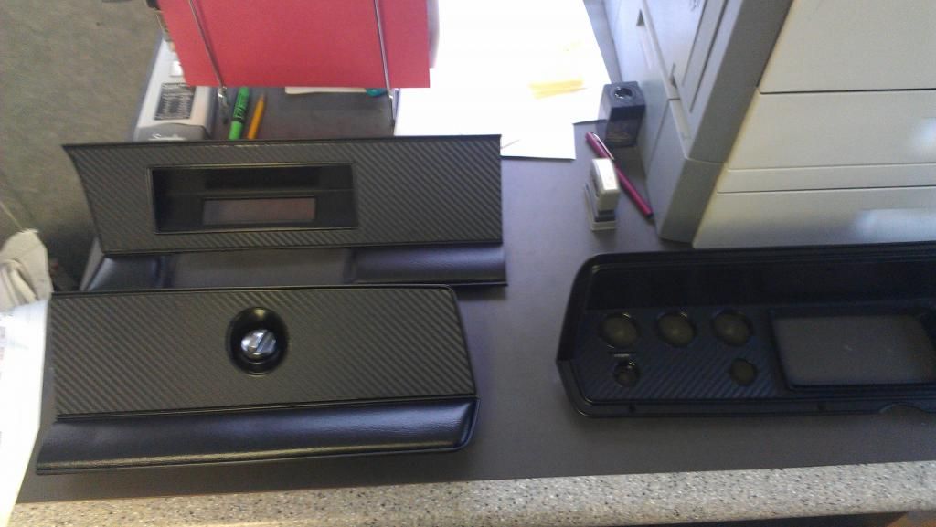

Also prepped my interior trim with a pressure washer on about the coldest night we had so far this year... but it blew all the old flaky layers right off. Going to use the SEM line of products to change the plastics and vinyls properly. I did make some calls to Detroit Muscle Technologies who are the people that sell the Carbon fiber and wood grain vinyl overlays for our dashes. I was hoping to get a matching overlay for the door panels but it doesnt look like they're going to release it as a product. Best they will do is sell the physical stock so that we can measure and cut our own. They gave me great price quotes and all that but if Im going that route then Im just going to order a small roll of black from ebay and apply it. The carbon fiber on the doors would probably be a little much Im thinking. I'll spray it first and see just how much of the wood grain laminate shows through.
