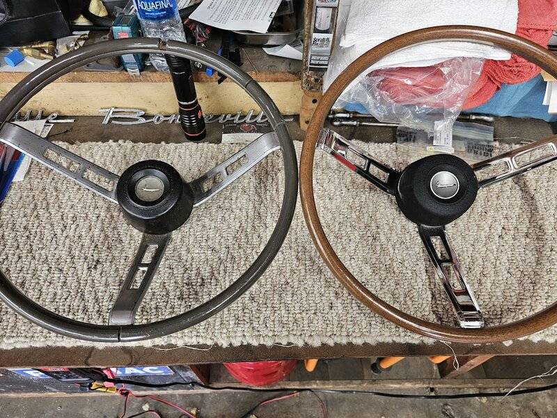

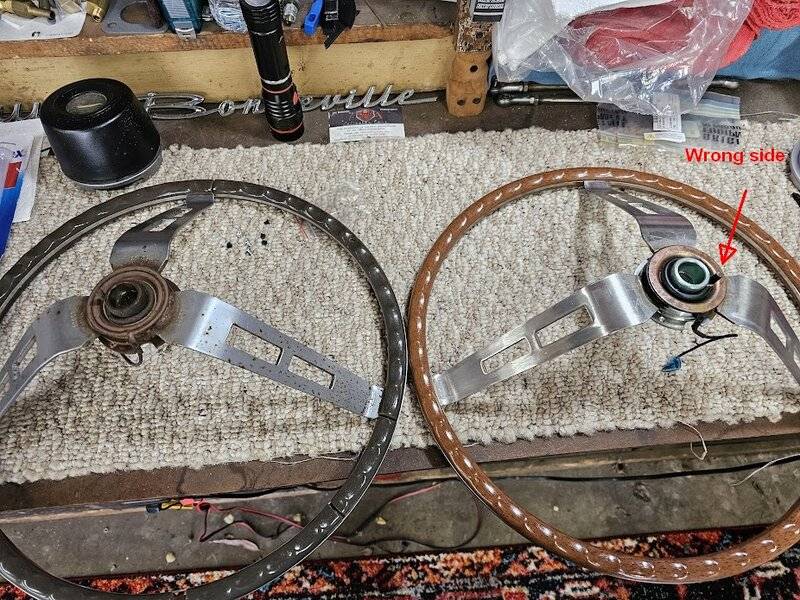

Before I took delivery of the cuda, I saw photos and immediately recognized that the steering wheel was old and tired.
I found repro steering wheels available from Classic Industries and ordered the full steering wheel kit with a new horn pad and center logo. I believe this is made by OER.
This would be my first experience with repop parts and it didn't go well. After a few weeks of reading these forums, I understand that repop parts are generally disliked and now I am starting to understand why.
Looks great. Can't wait to install it!
Uh, that doesn't look right.
The turn signal pin is rotated 180 degrees on the wrong side.
After I confirmed that it is indeed in the wrong position I was able to lube it up and gently tap it around with a mallet so it is in the correct position.
The horn didn't work! After some investigation I traced it to the connection on the new steering wheel. After cutting away the heat shrink I discovered a terrible solder job. I got my 80 watt soldering iron out and reset the solder connection and put fresh heat shrink over it.
Next problem was that the horn ring was contacting the steering wheel arms with a loud clank whenever the horn was pressed. The only solution I could see was to add washers to the assembly to add a little space. Problem solved!
I couldn't get the new horn pad to lock on the new horn ring. I discovered that the metal ramped surfaces were too rough and the metal tabs inside the horn pad were just digging into the soft metal. I smoothed these surfaces with a small hand file and was able to get the horn pad installed easily. (I don't have a photo of before)
I'm not happy with the gap behind the wheel but I don't think there is much I can do about it. I would like to take the wheel off some day and see if I can improve this. Obviously, the washers I added for space are somewhat to blame. It seems that this OER steering wheel assembly just has some finer details and dimensions that are a little off from stock.
As a final insult, the new Barracuda logo is rotated slightly counter-clockwise from the original and there is no way to adjust this.
In the end it looks great and is a huge improvement to the overall appearance of the interior.

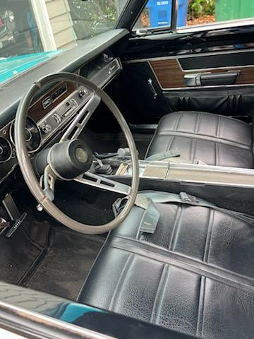

I acquired this Cuda from my Dad's cousin who had owned it for 53 years. My dad purchased it new in 1969 and drove it for 2 years and then sold it to his cousin who owned it ever since. Cousin Bill did his best to keep the Cuda in good condition over the years. I don't know the full history of the car during this time but obviously when he acquired it from my Dad in 1971 it was just a car that he used as transportation, not yet a classic. In the discussions that I have had with cousin Bill, I understand that he had a few people in his local area that would work on the car for him. So I believe he didn't do much of the work himself, especially in recent years.
The car presents well from 10 feet away but when you get up close and start examining closer, there are multiple issues in almost every area. So what I am faced with is not exactly what you would call a restoration but instead I will be sprucing up, tidying up and restoring or replacing worn or shabby looking parts. I plan on doing as much of the work myself as I possibly can. I have some experience tinkering on classics because I have been the proud owner of a 1960 Pontiac Bonneville convertible for the last 11 years. My work on the Pontiac was much the same as it should be with the Cuda as it was in fair condition when I acquired it but just needed attention to small issues all over the car.
I thought I would make this thread as a way of sharing my work and progress as I deal with various issues and maybe we can learn from each other.
Here are some pictures from day one when I acquired the Cuda.

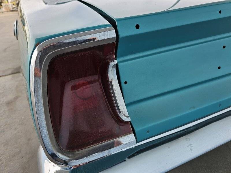

Beautiful color. If the Tail Panel trim is still not on, I just saw a guy who needed measurements for the holes in the trunk lid. The name of the thread is: 69 barracuda trunk trim mounting by @Cudafishboi
I don't really know how to do a link to another thread, but it was posted on Wednesday. You could possibly provide the measurements.
