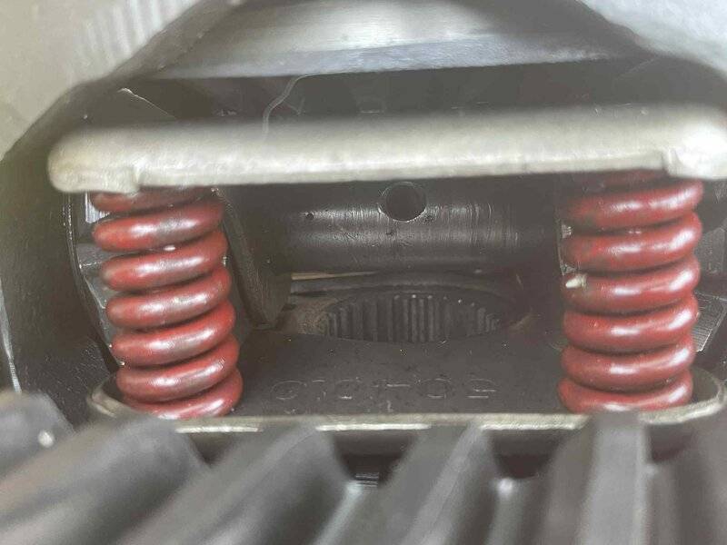

bought a 742 case 3.55 gear with a auburn grip and loc carrier. little too much power and it broke the button off the center pin and knocked one of the springs out.
anybody have a service manual / schematic for one of these things so i can order the correct parts? emailed auburn waiting for a reply.
photos. round broken "button" was on the center pin. spring came out i assume when the button broke. you can see in the third pic where the button went on the pin.
You already are overpowering it, it will probably happen again, maybe step up to a better clutch type if able .
It ain't broken.. The center button ejected and kicked a spring out. If your using green bearings leave the center button off. Just back the bolts off the case halfs and reinstall the spring. If needing a button salvage 1 from an open carrier they are the same. Or spend $200. The spring plates from your pics are in good condition.
thanks guys, i bought it off a guy this way as he went to a 9" i know cone sure grips are not that tough. its a 489 with new MP 3.55's ill fix everything and keep it
great advice. thank you. other than the case halves. haven't figured out disassembly yet. no case bolts. ill post a pic tomorrow. its one of the 22 projects i have on the go at the same time so sometimes it takes months to get the hamster back on the wheel.

That's incorrect. The newer Auburn units, which is what that is, are much stronger than their factory counterparts. They will handle a good bit of power. IMO, power output had nothing to do with that failure.
so what caused the failure? i did not do the damage. i just bought the aftermath. lol
does that cross shaft have a dowel to pin it or does it depend on the ends of the axle shafts riding on the button to keep it still?
if the shaft has spun, gotta find out why.
usual failure is the cones bottom out in the case leading to a 1 wheel burnout that puts the full torque through the pinion/spider gears to the side gear/cone and axle with no traction, which spins very fast. in that scenario your little spider gears are spinning excessively fast on their cross shaft. they just ride on the shaft, the chances of a seizure are large. if one of them grabbed and twisted the shaft that would bust your button
the other option would be that if the axle ends are supposed to butt up against the button to stop the shaft turning and the axles were too short or a wheel bearing collar moved. the space gets too great and the button twists against the axle shaft end and gets hammered at the next corner you take

We shouldn’t see the hole in the pin as pictured. The hole should be parallel to the axles to retain the buttons dowel pin.
yeah which means that pin has turned through near 90* but there should be a bolt close to one end of the pin that stops it turning it bolts in from one side of the case. that bolt must be snapped or missing i.e backed out due to vibration. allowing the pin to turn and put pressure on the central button until its small mounting stud snapped
what caused the twist in that shaft? it will dictate what work you need to do.
i have seen the type like my one above have the dowel hole that they use instead of a bolt wallowed out. and signs of smearing of spider gear onto shaft i.e a semi seizure.
was on a one for 2.77:1 gears so useless case hemispheres for any other application. the good parts became spares
you won't know till you pull it apart. but they are simple units, it will be obvious
lets hope the bolt just fell out
it should be in the bottom of the axle housing unless it got pinged down one axle tube or the other
Dave
Assuming the case is good and these are the replacement parts the OP bought, he should be good to go but I’d run Green Bearings and eliminate Auburn’s buttons…… The Auburn is a strong unit but the buttons dowel pin retention is the weak point of their design. Maybe there’s not enough space for a conventional thrust block.
