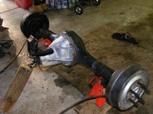

I never use the gasket, put some rtv/silicone on the housing and spread it around with your finger. Then just drop the gears in and tighten them up.
I agree, RTV is all you need, clean the surfaces, run a medium bead all the way around. Let it set up for 30 Min's or so and bolt it together. Been doing this way for years without a problem.
I only use silicone on mine too,never had a leak once.:cheers:
