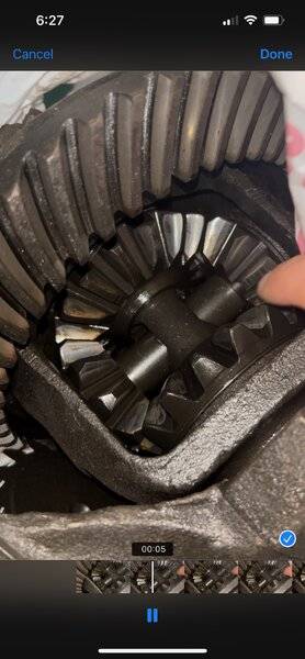

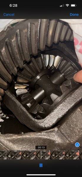

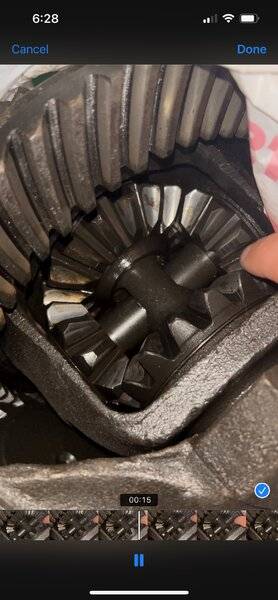

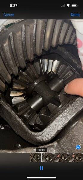

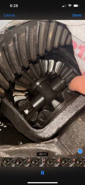

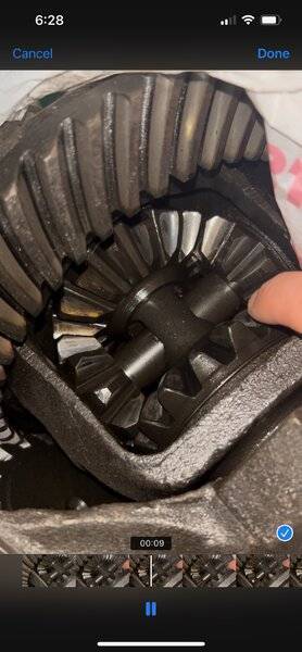

My first questions are in regards to my 489 case. I don't think I have the Sure Grip setup but I haven't been able to confirm nor deny. I have posted some pictures to help identify if its a Sure Grip. Can anyone help? I am also questioning the wear on the teeth on the inside of the gears. They appear to have proper engagement but I've read that engagement is something that cant really be seen. Would anyone suggest putting marking paint to view the engagement? If so, where would I apply the gear paint in order to see the engagement of the teeth inside of the gear setup? Also, do the teeth look to be in good shape? Or do they are worn to the point they need to be replaced (hoping not). What would you guys do? Do you think this is something that you would clean-up, assemble, and run? Or would you guys do a little more? Everything seems to spin smooth as butter, I don't think the bearings have any issues or anything of that sort. What would be the best way to clean this? Purple Power? Brake Cleaner? I will soak parts in oil to give them life again. The attached photos appear repetitive but I am spinning the gears allowing you to see all of the teeth. They are very uniform which is why it appears as the same photo but they are slightly different. Some teeth appear to be gouged and scratched but its residual oil. They are pretty clean and uniform.

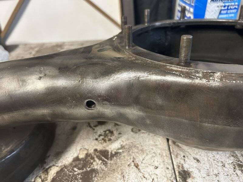

I am also unsure of the T-block, or Y-block that was screwed into the rear end housing. It was attached to the brake-lines but its a direct hole into the rear-end housing/axle. Does anyone know how this works? I plan on doing a disk brake conversion all around and will not go with drums. Is this something that I will still have to use when I switch to disk brakes? I'm not sure how that works at all so any info would be greatly appreciated.

Pics of Open Diff, not Sure Grip. Well the T block on top the housing multi-purposed. You need a flex house going to rear T block for a stock spring application because the rear moves, you need to split from one feed line to two lines, R & L side brakes, and the top of the hold down "bolt" is a vent for the housing.

Can't really tell the gear condition from your pics, angle, light or something or maybe it's just my old eyes. However if the gear faces aren't pitted and there is no tooth set wear that you can feel with your fingernail the gears may be good.
Differentials are pretty durable and if it rotates freely, the pinion seems captured and there is not excessive backlash ( .006" - .012") between the ring and pinion gear, (this is where you need the dial indicator), then it might be good to go.

The housing is a 69 or earlier due to the brake line location
The through hole is for a vent bolt the holds the brake line on
You rear is an open rear . Not a (sure grip) or (trac-lock)
