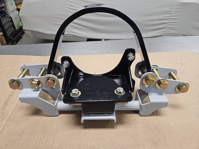

Has anybody bought the transmission mount at usct store?
HDK B- body version just out (first three pics)......no floor cutting
HDK A body version in the works. (last picture)
for 8HP70/90
includes adjustable height transmission mount reinforcement and install template
Does this work with the factory k-frame or does it require the motor to be forward and down a little?
It puts the transmission with adjustable cross member reinforcement as high as possible in the tunnel without major surgery. The crossmember transmission mount is adjustable front / back and up / down.
If I was doing an OEM K build, I would use the HDK transmission mount / A body version, do a slight mod to the tunnel (pictured),....and make it work.

Has any of the A body guys tried one yet? Price point?
original A body version, several tweeks and now 2-piece with the hoop mount separate from transmission mount to ease of install / removal.
version B.......$595 for the assembly, includes 8HP 70 / 90 mount (not powdercoated)

Main concern is placement.. I'm only 5/8 forward of stock location and I think the hardware is going to pretty close to the harness plug. Hard to tell. Also concerned that the upper hoop may not work without moving forward as well. Pretty sure that I need to cut off the rear tabs, regardless what direction I go.. I think! Still kinda just staring at it. Would be great to hear if anyone has used with a stock K and semi close to stock location.
@4.7Light used the stock location in his build.
Looks like his swap starts about post #664
[/URL][/URL]
The HDK mount is what I'm referring to...4.7Light cut up a mount that was intended for a NAG1, if I recall, and a universal x member support.
It looks like the hoop bolt might be exactly where my connector pops into the trans. I barely clear the x member now.. but I do need to cut a little more off yet. So the HDK may be fine as well. Just hard to tell
The pictures are from a 6.4 / 8hp70 install in a 69 Dart.
The mount was made specifically to do the least amount of sheet metal mods as possible but still fit, function, and install with relative ease.
For Denny's set that's for a Hemi 6.4 and moved forward and he used stock location cross member trimming of course. Very little tunnel work as well again Hemi is not for the weak you will be doing more than just this. Watched him share his work amazing kit if your going that route. I bet you could move the 360 forward they make a motor mount to do it.
On mine I had the built LA 360 and cost on my side this was super cheap. Amazing value for what a built 360 can do in front of an 8HP. I drive it everyday if I can grocery store anywhere!
My setup is trimming the left and right side cross member just behind the holes then I put a plate square closing that all around. I used a 3 inching dropped Mancini transmission mount. I put in 2 x 3 sqr tube frame connectors and then put the drop mount just behind it dropped right in easy peasy I probably went over board on trans tunnel but I wanted to have lots of room and my feet are fine. I also used 14 gauge cold rolled steel tunnel and made it much stronger. I got plans for turbos on the 360 someday and I need to make sure it won't twist.... it won't.
