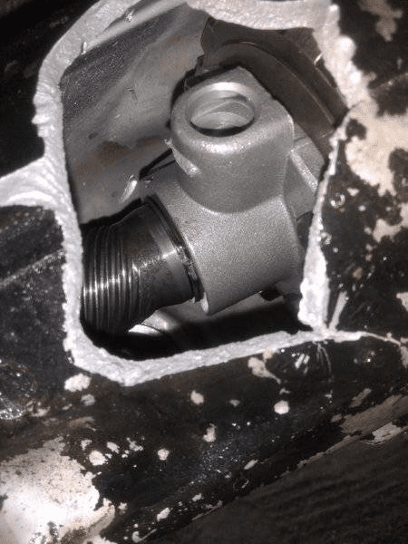

Governor blew apart, it happens.
A pressure test will prove it.

Can pull the speedo cable and look inside and see the governor to see if it came apart (or stick a scope in).. at least on my 62 trans i can, i would assume the newer ones also since they have a bigger speedo hole even..
Yeah, great idea, the governor is right there.
