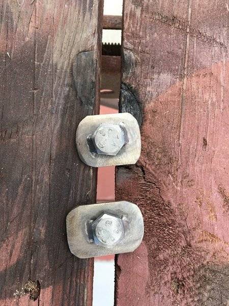

posted in original post. Arrow points to the area I sanded. 1 more thing I seen another member here do something similar with the manifold head pipe bolts, so I took his ideal and came up with this as an anti-rotation for the head of the bolt, no more fighting to get a wrench on the bolt head. Socket and a long extension from under the car and it works great. Enjoy.

Also this
