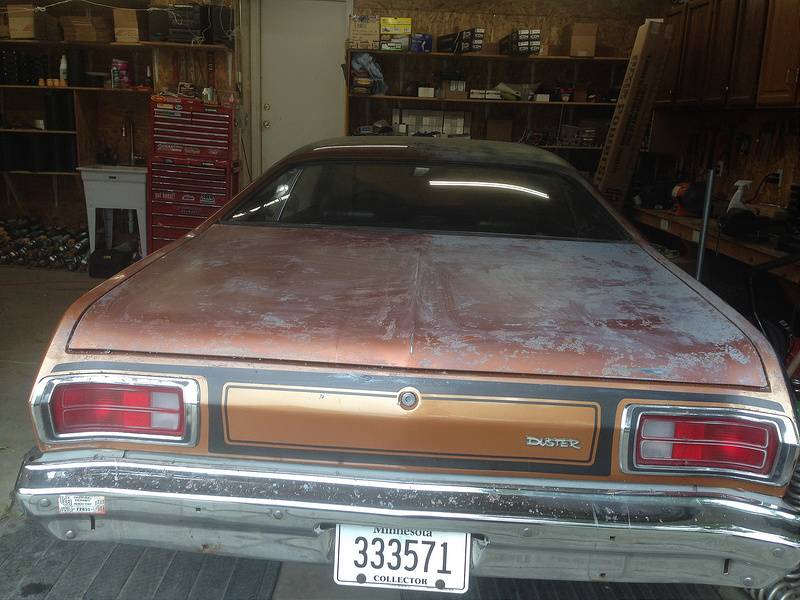

Cleaned up the rest of the windshield channel and primed. Also stripped the Napa Gold paint off the trunk lid. No filler YEA!, just lousy paint and primer. Still gotta take some more of the primer off to get to the original Sienna Haze paint, but I am almost there.

We took ours down to factory paint. Now the car has panels from everywhere so that was different on the hood, deck lid, both fenders and the valance. The right fender was sanded downtown bare metal with cheap rattle can primer. That came off with lacquer thinner and a rag. Used etching primer on that only.
I figured if the factor paint was still solid 42 years later why not leave it?
We did a light sand then 2K primer, then build primer, blocked it then base clear.
I think leaving your factory paint as a base is a good move.
Very modest paint job that looks nice

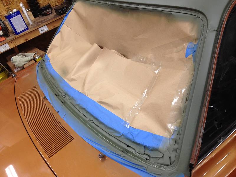

There's always more than one way to do things. I wanted to take the glass out to inspect for rust, fix it if I find it, and then reinstall the glass with new rubber. I will do this for the rear glass also. Well I thought hey lets paint the channel while I have the glass out and this will also serve as a test to see if we like the color. So, Lil' Sassy in the windshield channel, and 3 coats of clear.

And this morning, I think we all like it here!:

Keep going. And take those nice trim rings off for now so you don't over spray on them
