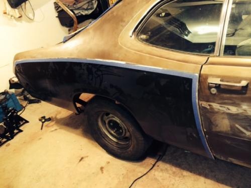

I started the spot weld cutting of the quarter panel. I messed up in 3 spots and went all the way through. I will weld back those holes. But the removal of the 1/4 panel is in progress! I cut the lip off after the spot welds were cut.

I had a bunch of guys tell me not to take out that door seam or remove the above the bodyline...We did both skins lap welded. We cut the old skin to about 3/4" from the high bodyline and the door seam. The pic I show of our cut is the rough cut.
For a purist, I think the way your going about it is the best, but I'm happy how ours came out too....
