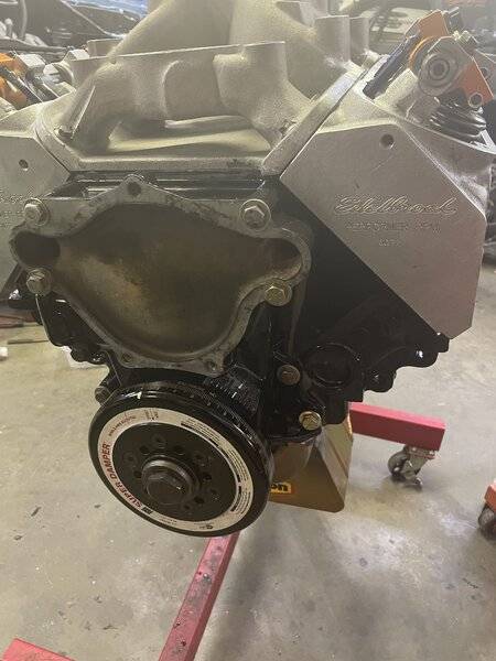

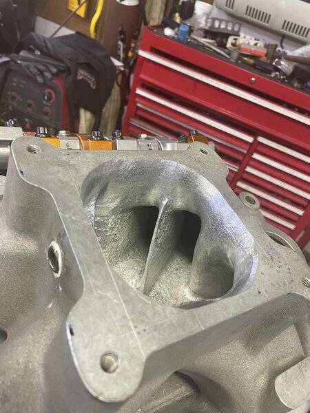

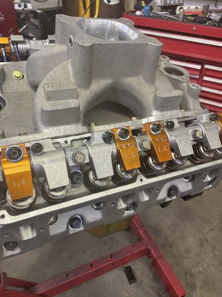

We I still have to make some pushrod clearance on my valve cover spacers, clean up my valve covers, check my valve lash settings one more time, and my new valve cover gaskets will be here tomorrow. After I pull my 422 out I can transfer over my engine plate and 90 degree oil filter adapter and prime the oil system. Then it’s install time. Hopefully it will be running this week.
Judging by the offset rockers, these are your moved pushrod Edelbrocks? Are you going to dyno it or just track times?

We I still have to make some pushrod clearance on my valve cover spacers, clean up my valve covers, check my valve lash settings one more time, and my new valve cover gaskets will be here tomorrow. After I pull my 422 out I can transfer over my engine plate and 90 degree oil filter adapter and prime the oil system. Then it’s install time. Hopefully it will be running this week. View attachment 1715745745View attachment 1715745746View attachment 1715745747View attachment 1715745748
