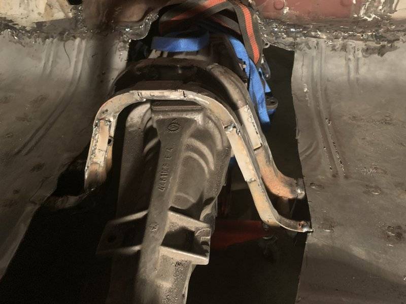

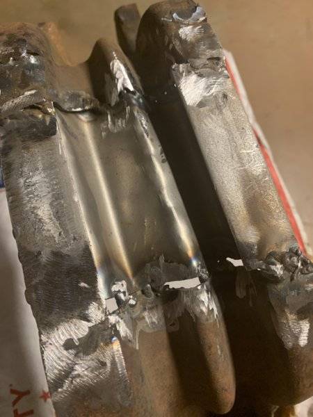

i started at 4 inches and felt it was a bit too wide. It’s now about 3.5 inches which leaves enough room on either side of the transmission at where the motor mount is located. Once I actually start fitting the trans I will adjust the height of the upper crossmember to fit the trans. As you see I tried to follow the stiffening rib from side to side.
I found that I needed to lengthen the sides to clear the transmission height-wise which meant the top section that I fabricated needed to be shortened quite a bit - down to about 2 inches. It’s all done and mostly welded to the rest of the crossmember on each side
So what angle is your output shaft at? Getting closer to mocking up mine.
Angle of the output shaft: I will have to determine that when I fabricate the lower trans support and can do an accurate measurement. Reason: Right now the wagon is completely gutted including the K Frame. I used my transmission jack to raise it up into where it’s close to what it will be - thanks @sgrip65 for sending me the measurements from the top of the trans to the pinchweld and trans to firewall! So At this stage of the tunnel/crossmember mockup, all I was doing was making sure I had sufficient room between the transmission and upper crossmember support. I had to re-work my initial fabricated piece to raise the height for clearance so I’m good now in that respect. To get an accurate angle measurement I will temporarily mate the trans with the engine and that to the K Frame and back in the car. Then I can adjust the tail of the trans to get the angle as close as possible before fabricating the lower trans support. It will likely be awhile since I’m just an old one man band so to speak.

I’ve got the trans on my trans dolly and it’s been under there And back out several times already - luckily the dolly rolls pretty easy. When I mate the motor and K, it’s gonna be a one and done as far as fitting everything and then a one and done on the final install.
Here’s a shot of it from the front before it was completely welded on all sides to the left and right remaining crossmember.
