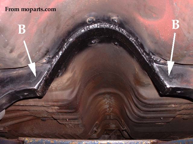

A 518 is not gonna fit without floor work, either. My understanding is that only the smaller A500 (904 based) will fit and even that requires what might be called extensive rework of the crossmember. There's a thread on here about that

I'm planning (if i live long enough) on an A500. It's a 46E series, meaning electronic. I've read (Transgo? I think) that you can turn it into an "all manual" box, needing a toggle or whatever and or vacuum switch for the OD.
A500 42RH swap
http://www.forabodiesonly.com/mopar/showthread.php?t=178459
crossmemember mods

I don't mind doing a bit of floor work to get an overdrive. So does anyone make a cross member for this swap or would anybody be will to make me one?
