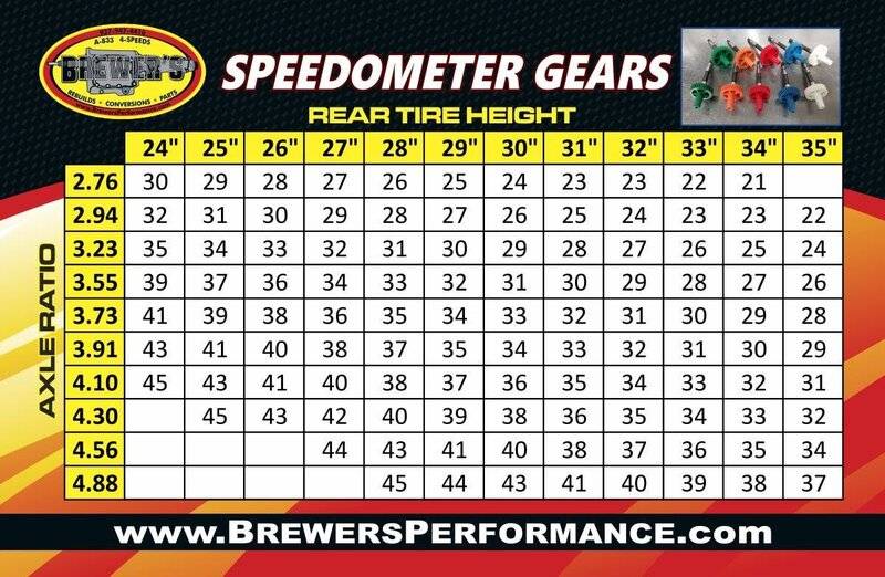

Since my speedo was out on my '70 Swinger, I put a new speedo drive in her A833. Since I dont know my diff ration for sure, I did the tire/driveshaft rotation trick and figure I have a 3.55 installed; I measured the circumference of the shaft and laid a piece of masking tape on it measured out in inches, it came around 3 full turns, and stopped somewhere between 3.55 and 3.73, probably around the 6-6.5 mark, so I just put it off to rough measurements and called it 3.55. With a tire height of 25 1/4"(again, rounded down to 25" for the chart lookup), Brewers chart tells me I need a 37 tooth drive, so thats what I put in her. The speedometer is slow, so I double checked the numbers tonight and I got the same as the first time.
So rather than play an expensive game of guessing the gear, should I go with a higher or lower tooth drive to increase the speed approx 5-10 mph?
If the speedometer is slow, you would want to decrease the number of teeth on the gear. I would drive the car off GPS (phone has one) at 60 mph, and then reference the speedometer in the car. We can do the math from there to account for discrepancies in tire size/gear ratio/speedometer calibration.
To get an exact number, you just calculate the speed difference you want, in percent, and get that same percent difference in number of teeth.
If your speed difference is 5%, then your tooth count difference will also be 5%.
If your speed-O is indicating slow, to speed it up you will need fewer teeth, and vice versa.
5% on 37 teeth is just 1.85 teeth. Now look on the chart at 25" tire, and see that the difference from 3.55s to 3.73 is 2 teeth; see what I mean. The chart assumes that you know the exact rear-end ratio. and it assumes your tires fall on the sizes indicated, BUT a size difference of .5 inches in diameter is actually 1.5 inches in circumference which is what the charts calculations are based on. Therefore, sometimes, as in your case, you would have to guess at a tooth count between the chart numbers, of 25 and 26.
Thus not knowing the exactness of anything, you are looking at a range of Speed-O gears on the chart, between 36 and 39
Whereas, the Percent method will tell you EXACTLY how many teeth to add or subtract to whatever is in there right now.
But I gotta tell ya; from 3.55s to 3.73s is a 5% difference, so maybe you want to revisit your differential ratio calculation cuz 5% at 65 mph is 3.25 mph. So if you got that wrong, the chart won't work for you ............ but the PerCent difference method will.

I actually didnt guess when I came to the height of my tires,(but I did round off so that I could use the chart) I took one off and stood it against the garage wall and using a square, marked the height against the wall and measured from the ground up, same way you would measure the height of one of your kids with their back against the wall :) That method gave an actual measurement of 25 5/16. I just measured the circumference of the tire like you suggested, and got 80" as the circ. Doing the math gives a height of 25.5", so given that Im not using exact laboratory scientific methods for measuring, Id say thats pretty close :) .
I dont know how much more accurate I could be with the gear ratio, I measured the circumference and using masking tape, marked it out in one in increments with a half way point which would give me a 3.55 ratio should it stop there. Twice it gave me a slightly more than 3.55, but slightly less 3.73.
My next step, is when it stops raining to do an actual speed test against a GPS and see where Im standing like @Dan Brewer suggested.
Thanks again for all the info.

@Dan Brewer , so I did a speedo check tonight against a gps that I had downloaded onto my phone, seems my speedo is 10 mph slow according to the gps, I took readings at 60 50 and 40 on the gps, and at every one, my speedo is 10 mph slow.
What do you think??
